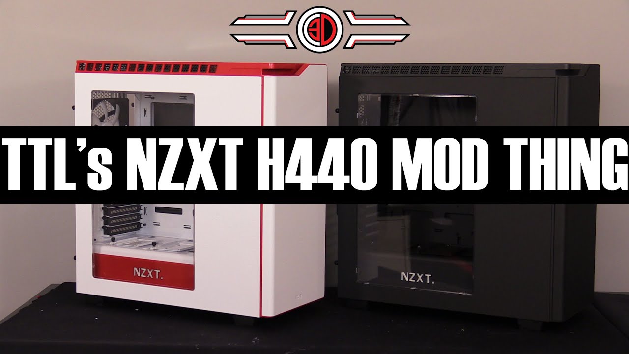

Absolutly! Myself and a few other members have done the exact if not a verysimilar thing to what you want to do
https://forum.teksyndicate.com/t/nzxt-h440-mod/94067
The H440 is very easy to take apart and put back together
Obviously need a well ventilated space, some painters tape and paint (I recommend `Rust-Oleum')
Basically just get some paint for plastic and you should be Okay. The most important part of painting anything is getting the surface prepared, masked and clean before you start. I prefer to use paint from the auto parts store because of the great color selection. For plastic paint stick with a name brand like Rust-o-leum or Krylon. In reality I have painted plastic with automotive paint with no problems, but sometimes regular paint will melt the plastic or make the surface permanently sticky. Test a small area first.
