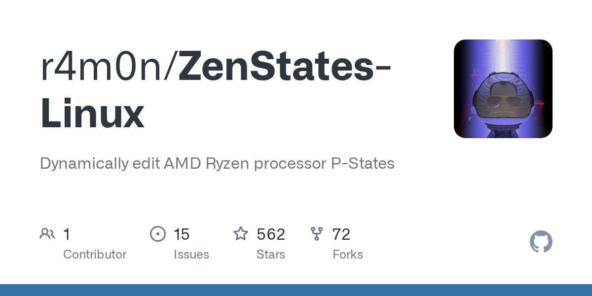

2. Download the following repo
git clone https://github.com/r4m0n/ZenStates-Linux.git
