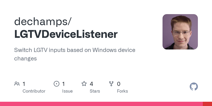

Also trying to figure out if there’s some way to hack one of the above USB switches + a raspberry pi or similar to handle switching the LG HDMI input with this:

Seems like this is the only way to have all 3 (until a 4xHDMI 2.1 switch comes along, and even then I’m not sure it would preserve VRR?)
Would I be correct in assuming this isn’t going to work?
I have no idea, this is an @wendell question.
