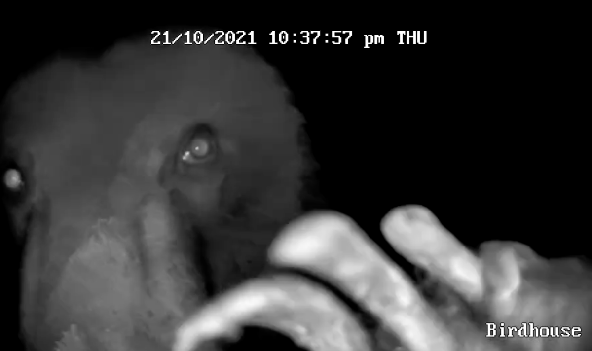

This video is for those who might be interested in seeing me spray a bear point blank in the face (just one of three I sprayed that spring) or the helicopter sling loading an ATV and culverts to our property, or want to see real-life monsters destroying our yurt or to peer down the throat of the bear pictured in the OP, or our solar setup, bacon cooked on a rocket stove, or the cutest baby squirrel ever doing the baby squirrel dance, or the raven who stayed in our cabin, or DJ E the ermine running around our cabin like she owns the place, or cabin insulation or just beautiful mountains and multiple glaciers, you might enjoy this video. Or if you want to see disgusting dirty fingernails, this video is definitely for you (off grid no running water life, represent). All video was taken from our homestead. We’d appreciate any feedback on if the narrative format is interesting enough or distracting or unappealing. Our desired brand for a potential channel is, as my wife says, “nerds in the wild.” Fusing tech and off grid living; automated nature video combined with us building tech for off grid life. We’re not good nerds, and we’re not good homesteaders but we dabble in both. Many thanks in advance to anybody who takes the time to watch and provide feedback!
