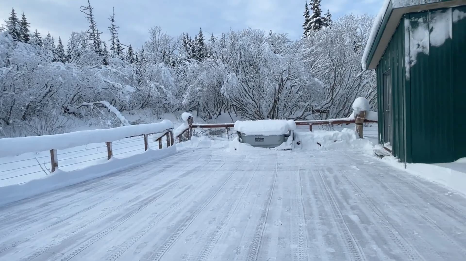

In the off chance that somebody here owns a Yarbo, we’re going to buy one before this next winter to keep the deck clear of snow if we take a weekend trip to the big city. Should be able to work autonomously and we confirmed that we can set it up and then deprive it of Internet so that it’s not spying on us (of course it might have a SIM card built in somewhere).
For now I just use a lithium battery powered blower and it works nicely.
