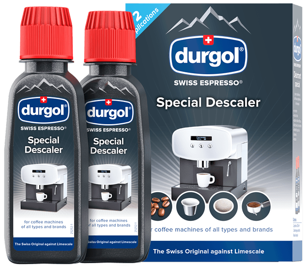

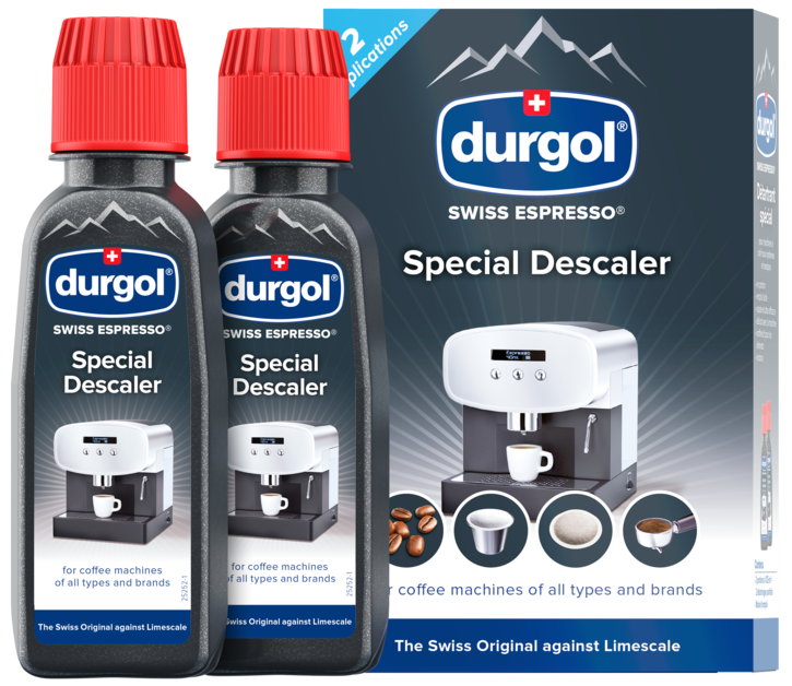

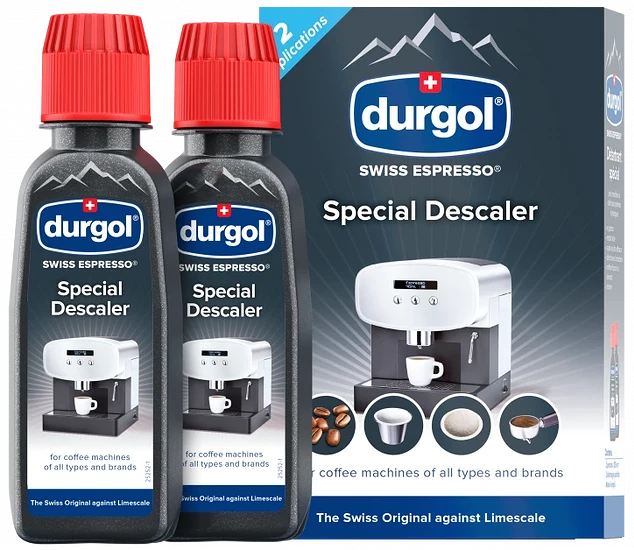

Personal sad story: In the distant past I had destroyed nickel-plated parts with citric acid (didn’t know any better). Temporarily this was a while before I built the 8-year loop system.
Randomly around that time I had a coffee maker defect, the heating group had an electronic fault. While disassembling it I noticed that the mixture of different metals, plastics and silicone ring seals in the coffee maker that were in contact with the hot water and brewed coffee looked pristine, even after years of almost daily use.
I then looked up the cleaning solution I used for that coffee maker, it’s a product by the Swiss manufacturer Durgol that sells many pricy cleaning liquids with varying criteria. The one for the coffee maker is called just generically called “Spezial-Entkalker” (“Special Descaler” in English).
That stuff claims to clean as well as descale and that it’s less aggressive than citric acid and vinegar (it’s based on sulfamic acid). Be careful if you choose this one, that manufacturer sells MANY different but similar sounding stuff. Sulfamic Acid can be used with blank copper parts (even cleans them from corrosion) BUT it will also attack nickel plating when being in contact with it for a longer period of time.
It’s designed to be used diluted in hot water, ratio 8 parts (water) : 1 part (special descaler).
  • In chemistry for every 10 K in increased temperature within a certain range you can basically increase a chemical reaction’s speed 2x to 3x. In German this has the charming term “Reaktionsgeschwindigkeitstemperaturregel” ( RGT-Regel – Wikipedia ).
