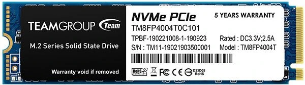

So, I’ve said it for a while… My new favorite low power setup is an Asustor Flashstor 6 bay All-NVMe NAS as a foundational server, plus a Ryzen 9 7900 separate box.
NAS: Asustor Flashstor 6 bay full SSD
First, the NAS. The Asustor Flashstor 6 bay costs ~€500, VAT inclusive, and 4TB SSDs are ~€200. This means a fully decked out Flashstor with 20TB of redundant storage costs €1.7k. This beast will draw 13W idle and less than 25W when fully hammering those SSDs. This equates to a worst case of ~18 kWh a month, a more realistic estimate would be somewhere between 10-14 kWh.
Only downside is the lack of ECC, but this is not critical in a home setting, we are talking maybe three or four bitflips a year and the chance of that ever impacting data you actually care about is low. Most of the time it will mean a millisecond lost in an audio file, a green pixel instead of a red one in a photograph or even a corrupt frame in a video. These are annoying, but easy to fix.
Server: InWin Chopin Ryzen 9 7900 with ECC support
I used German PCPartPicker here to get prices in Euros, but apart from the CPU pretty much everything in this build is replaceable. I go with an InWin Chopin build here, but things like case, motherboard et cetera can and will be replaced according to your needs. RAM as specified is not ECC, but the system does support (unbuffered) ECC RAM.
| Type | Item | Price |
| CPU | AMD Ryzen 9 7900 | €422.29 |
| CPU Cooler | Noctua NH-L9A-AM5 CHROMAX.BLACK | €59.90 |
| Motherboard | Asus ROG STRIX B650E-I GAMING WIFI | €281.81 |
| Memory | Corsair Vengeance 2x32 GB DDR5-6400 CL32 | €224.50 |
| Storage | TEAMGROUP MP34 1 TB M.2-2280 PCIe 3.0 | €55.28 |
| Case | In Win Chopin MAX w/200W PSU | €139.00 |
| Total | €1238.06 |
This server will draw a maximum of 200W which equates to a worst case of ~145 kWh per month. A more realistic number would possibly be 60 ± 10 kWh a month.
