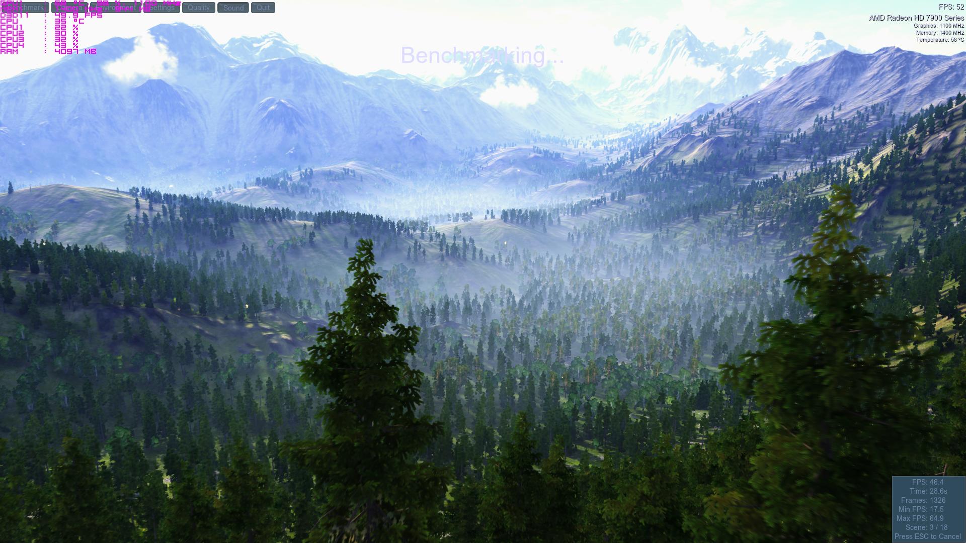

One: I've noticed that VRM Temperature 2 in GPU-Z stays the same, all the time. It's at 72 degrees atm constantly.
Two: When I run heaven in OpenGL, at stock or overclocked, this happens:
Clouds rendering through terrain? the 390 8GB VRAM cards work best at 4k btw, 1080p will see little/no improvement over the previous generation.
It's not clouds. Trees mess up too:
It happens in valley too.
Scrub-a-dub-dub.
Well, I've done that and tried guru3D's driver removal tool too and it still no workey.
OpenGL bench on valley is fucked up like this on my HD7950 i suspect it's a driver or software issue my card has not had any problems in its 3 year life that ive had it.
Ahk, won't bother trying to fix it then lol. It's only a benchmark I suppose.
Yup, 1.3 is terribly high without liquid cooling however even at stock my 7870 pulls 1.2v so I'd say 1.25v is a safe max.
LOL. Its just snow /s
Wow yep that's what I get. Will make a screenshot and try and match it tomorrow haha
Yep the card dosent give a crap about DX11 but open gl? dont know whats going on there lately.
