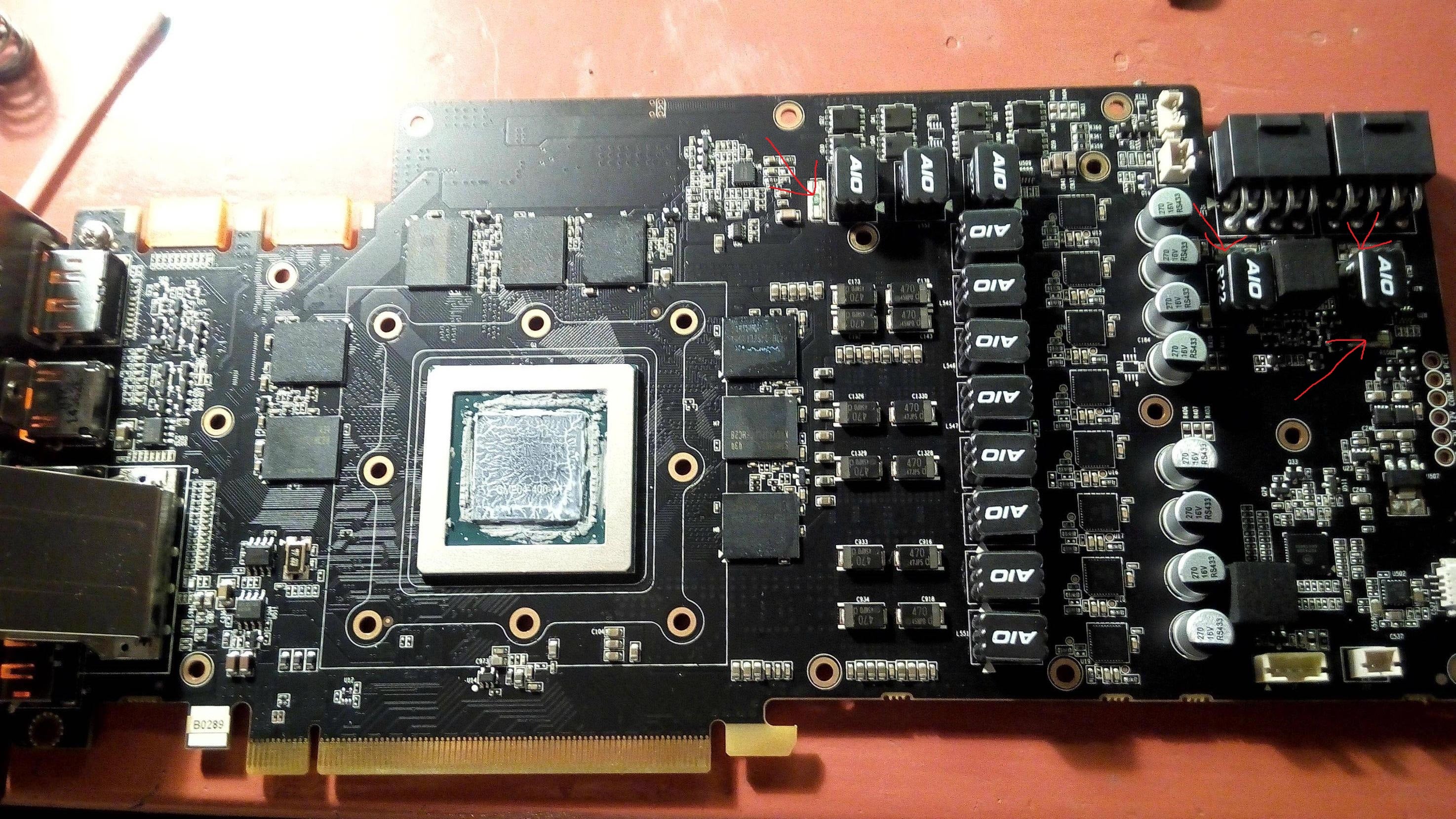

I certainly believe, at least inside any EU country you can put on any aftermarket cooler you want without voiding warranty. CPUs have overheating protection built in. E.g. Zotac stated for their GPUs you can even replace the complete cooling solution, overclock like crazy, still warranty will be intact, as long as you don't do something funny, like that kind of stuff:
