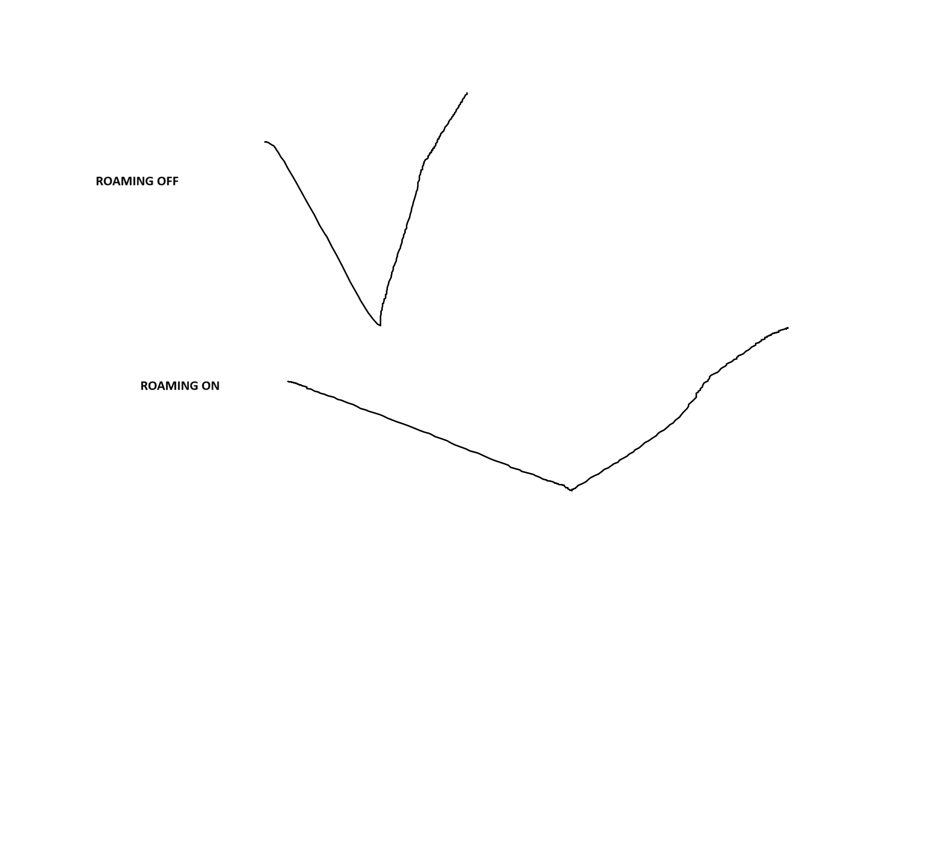

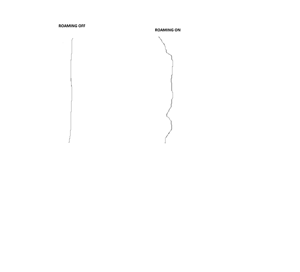

Enabling roaming changes the motion pattern regardless of DPI settings on mouse and/or KVM switch.
I’m attaching a couple of photos to illustrate. I tried to draw same lines in both examples - roaming drastically changes the handling characteristics of the mouse. I was able to replicate the same behavior on both my Keychron M7 and my Razer Basilisk V3 Pro.
Otherwise the roaming functionality works great! Appreciate any help!

we have the hotkeys for doing x and y tracking calculations separately. I think in roaming mode it assumes a 16x9 aspect ratio monitor but that could be changed via hotkey which is likely to improve what seems to be the horizontal tracking not being as expected?

Can you verify you have tried the hotkey combination below:
Hotkey Leading Code + L-Alt(Hold) + / + X + Y
Where X Is the Horizontal Ratio and Y Is the Vertical Ratio ( Rounded )
Example:
Monitor resolution is 3840 x 1080
  • Plug that into this website.
  • It will show the aspect ratio is “32:9 or 3.56:1”
  • We want to use the latter. In the hotkey formula: fill in X as 3, and Y as 1.
L-Alt(Hold) + / + 3 + 1
or
L-Alt(Hold) + / + 4 + 1
^^ you can decide which is better
Aha! That is much better! I setup some macros on my keyboard to change aspect ratios as needed based on this information :slight_smile:
