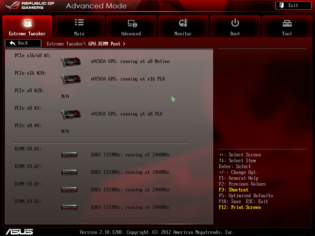

Depends on mobo but here is an example
I'm checking to see now. I'm running an Asrock board so we shall see.

Seeing mutation666's screenshot, another thing you may wanna take a peek at (if your uefi offers it) is the power monitoring. Some motherboard will actually show you the output from your power supply... look around in any overclocking/power/system health/monitoring section. It may provide some useful info. 12v, 3.3v, 5.0v, -12v (usually 11.8ish with no load), -3.3v and -5 as well. If it lists a 12v2 or something thats > 11.85v that points to psu.
