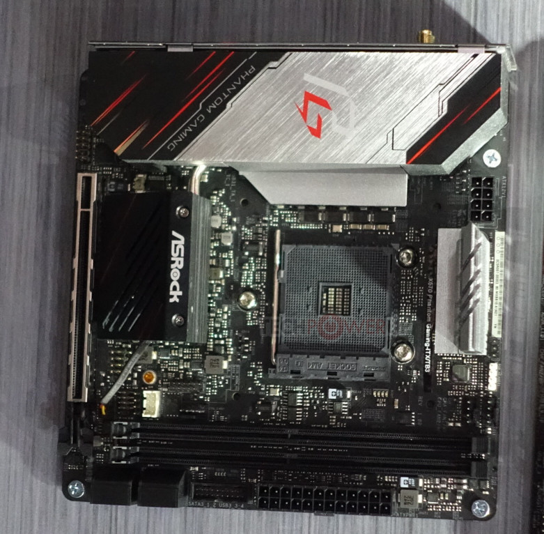

I’m leaning towards AsRock as I’ve heard good things about them, but here are my current options that are available in my market (from B450 to X570):
https://www.msi.com/Motherboard/B450I-GAMING-PLUS-AC
As you can see, not a whole lot to choose from.
Yeah, that is an idea as well. The B550 should cost a little bit less than the X570. Of course, I want to wait for something like 3 years before getting the next APU after this purchase either way.
