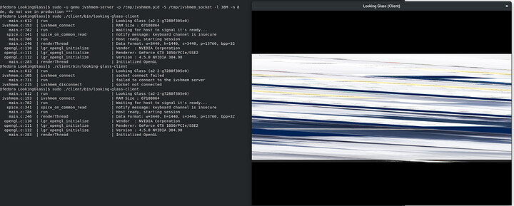

still giving me
cannot open shm file ivshmem: Permission denied
cannot bind
is the /tmp/ directory fine if I leave the code as it is presented in the guide? Or should I point it to somewhere in my home directory?
What’s giving you the error? You’re going to need to be a bit more specific.
unless your user has access to /tmp point it to a folder in your home directory. Worked for me.
That’s one option. Another option is changing groups around. You could also run ivhsmem-server as qemu and add yourself to the qemu group. (if not already in there)
Distro?
Haven’t experienced that before.

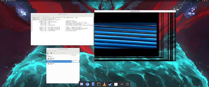

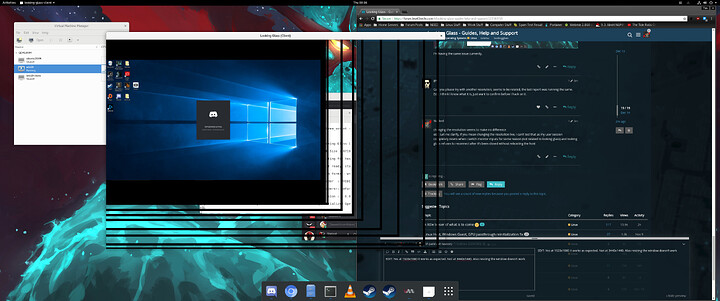

Looks like the stride is out… what is the guest GPU?
Guest GPU is a EVGA GTX1080 FTW. Host is Fedora Rawhide kernel, 4.14.3
Can you try to change the guest’s resolution?
Also don’t run Looking Glass as root, add yourself to the qemu group so it can access the ivshmem server without the extra access.
Will take another crack at it tomorrow. Don’t think I got the permissions quite right on the ivshmem socket so it’s not able to connect without sudo for the moment.
No worries. The problem with the output is clearly a bug though, it’s not due to your setup.

Can you please try with another resolution, seems to be related, the last report was running the same.
Edit: I think I know what it is, just want to confirm before I hack on it.
EDIT: Yes at 1920x1080 it works as expected. Not at 3440x1440. Also resizing the window doesn’t work.
