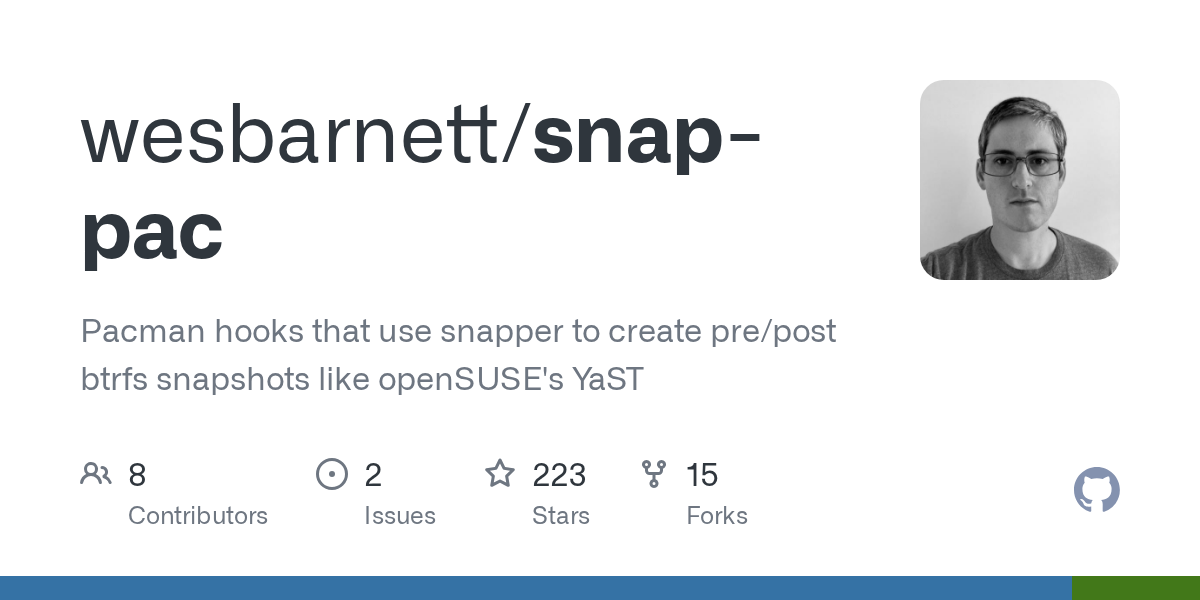

snap-pac is an arch tool for hooking ALPM with btrfs. I’m using that for some reference, but I’ll need to write my own scripts for managing the datasets.
