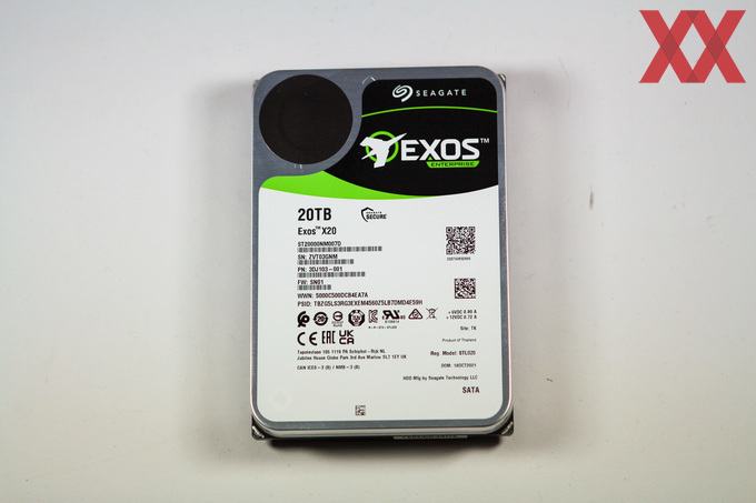

Exos 20

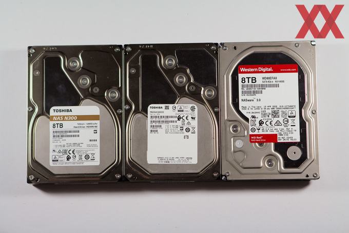

Hardwareluxx does reviews including noise measurements. Those don’t tell you the whole story because the ‘kind’ of noise can be as important (or more) than the volume in dB. It’s in german but that should not be an issue in 2025. Sadly they don’t list all measurements in all reviews so you might need to search through it a bit to piece everything together, e.g.

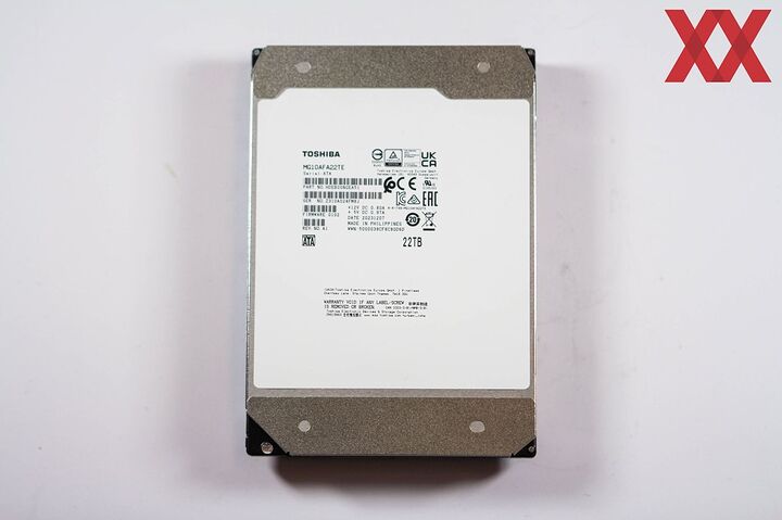

Any modern enterprise drive should be plenty reliable (Exos, Toshiba MG, Ultrastar or the WD red pro/gold). Quietest of the bunch do indeed seem the exos x20. The Ironwolf Pro are even quieter but much more expensive for what is basically the same hardware. I believe they are identical to exos, just with a firmware that is tuned more to home/nas use.

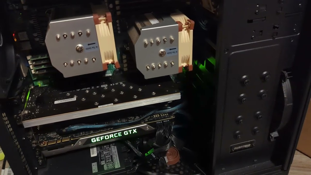

My backup Workstation in my office has 6 HGST 7200rpm SAS drives in it, and it is pretty good from a noise perspective. I built it into an OG Phanteks Enthoo Pro case. But there are many options out there.
For what it is worth, here it what it sounds like with 6x 4TB HGST drives in it. Most of the noise is fan noise.
Though, this one is only sporadically powered on, so I didn’t get obsessive about noise. If you have a noise focused build approach you can probably do better.
