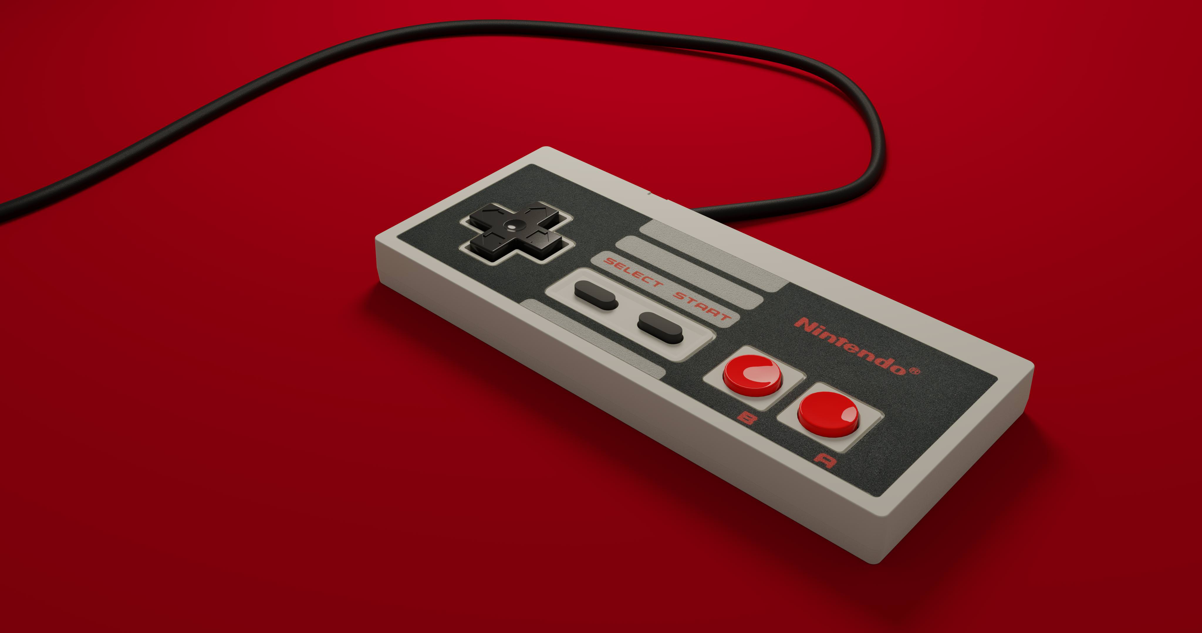

It’s 3:30am and I couldn’t sleep. So I made a controller.
