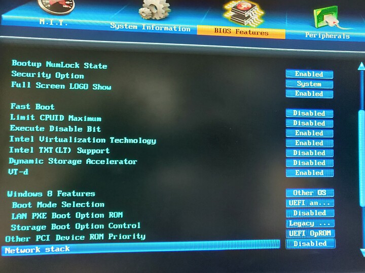

I had the same issue during dual boot of xubuntu 14.04 and windows 8.1. It too would infuriate me where it can and will stay shut off in windows during shut down but not in xubuntu. I was not able to replicate it’s origin as you were with Ethernet cable (I was using a USB wifi device). I also had a gigabyte motherboard (amd CPU, but I recognize the bios) and from your screenshot the only setting I can distinctly remember being different than my own setup is the boot load selection was set to UEFI only. So keep messing around in the BIOS, and I wanted to say you are not crazy :slight_smile:
