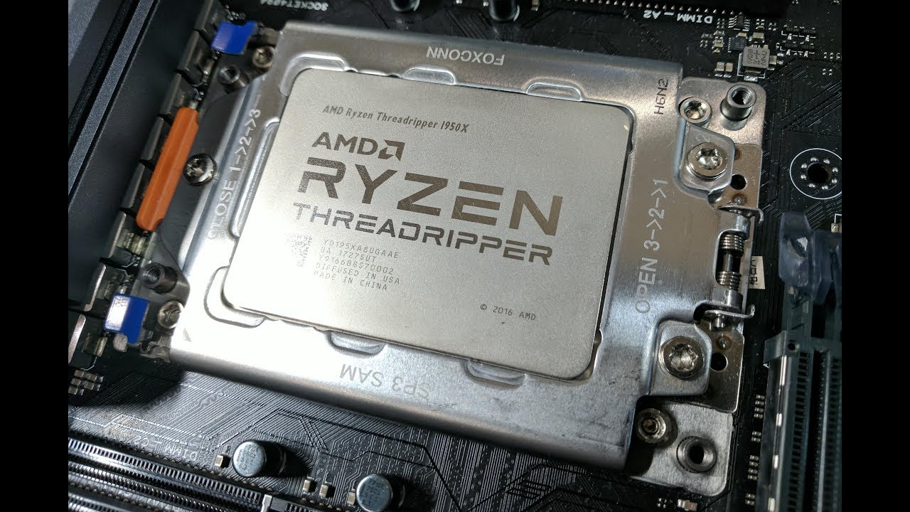

Hi all,
So this just landed thanks to Jay
and I posted a recording I made, installing the my 1950X on the exact same Gigabyte Aorus Gaming 7 X399 board (well, identical model)
Amazingly enough, I did not have as much trouble during my install. For my next system, I’m swaying a bit more towards getting an Intel 7900X/X299 box (plus for other reasons) - see linked thread. – TL;DR since I already have a killer TR4 box, having a decent 10 Core/20 Thread intel counter-part won’t hurt. Many here have confirmed that IOMMU is far more reliable on the Intel side of things.

@bsodmike In your video you already had the TR4 pins protector removed. This should not be removed until you already have the CPU in the bracket and ready to close. Although your install is similar to the one I show below, I would recommend not screwing the #2 and #3 screws down so much at first. The pins on the TR4 socket are very easy to damage. You may not even realize they are damage till you remove the CPU at some point. This happened to me.
I highly recommend using this technique. I have used it since my 3rd CPU install without issues.

My board never came with a Socket protector!! Straight from Amazon BTW. That’s there to protect accidental CPU drops yeah? It only had a dummy-translucent cartridge in the slider.
Thanks so much for the video - that’s BRILLIANT. I love how he turns backwards, just to find the ‘threading’ point.
