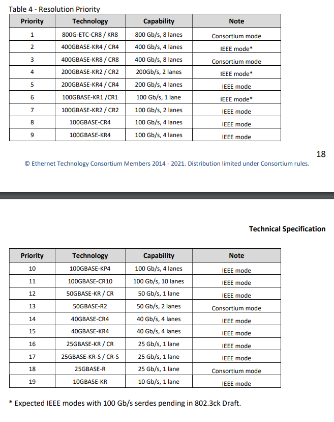

You really have to do some research in these higher bandwidth products, as what you get is all over the place. For instance, with 800gb Ethernet you sometimes have 8x 100gb links, sometimes 2x 400gb links, sometimes 4x 200gb links (extremely rare). The official spec is the 8x 100gb one, but even the Ethernet Consortium acknowledges that they dont care how the 800gb is made up, and people could even do 16x 50gb links though no one has so far to my knowledge. Think of modern, high bandwidth Ethernet more like a PCI-E interface and how we use 16x lanes for GPUs.
Just look at all the official specs for ways to do high bandwidth Ethernet :man_facepalming:
