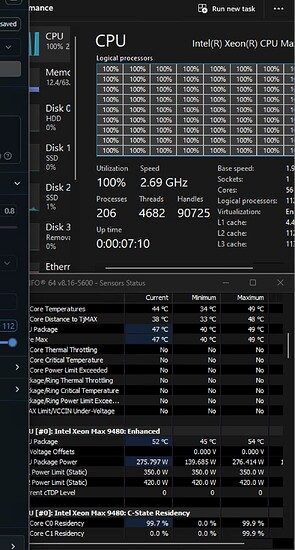

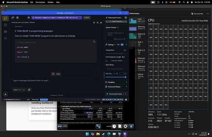

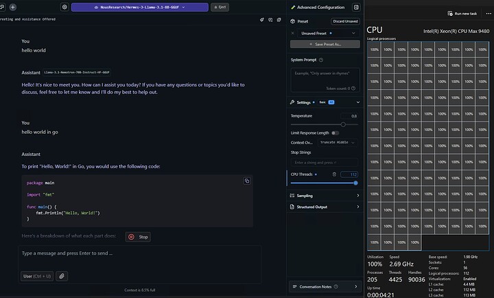

It feels quick in windows but when I run LM Studio(fancy GUI for LLama.cpp) and run it across all 112 threads I get lower results than 32 threads. I reckon the issue is that I am getting severely throttled. I was seeing 500MHz reported under a power virus(fully loaded llama.cpp). HWinfo is reporting 260W CPU draw under load. Intel has these chips marketed for 350W and the board has 2 8-pin cpu headers for extra power. How can I let the CPU stay clocked higher or set manual multipliers?

thanks for replying, here are some new metrics:
  • my bios tweaks have the chip bottoming out at 1.4GHz
  • I have a beefy aircooler with push/pull fans in an open case
  • max temp per throttlestop and hwmon is 60 c
  • avg power draw per hwmon 260W with max of 314W (I assume this is a 30 sec boost)
  • Windows is in high performance power plan with minimum CPU @ 100%
  • cpus range from 50-54c accross the die

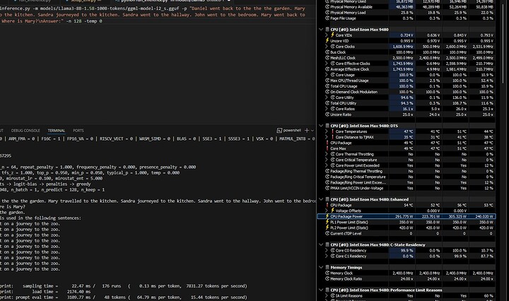

I briefly hit 320W @2GHz but it was shortlived, then it clocks itself down to around 270W per HWmon

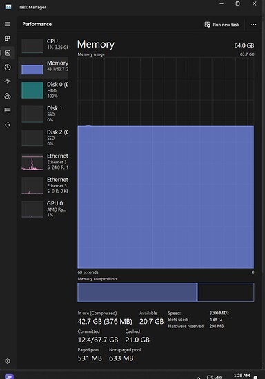

The RAM isnt straightforward, I think its running the HBM2 in cache mode, the bios settings werent very clear. Im also on windows so Im not sure if windows can even handle it appropriately. The only good sign is that AIDA64 trial said I was doing 460GBps on 2 ddr5 dimms so I assume thats the HBM caching.
Although I have the sneaking suspicion that the ddr5 isnt being detected and its only see the hbm…

Here the 32T run has clocks over 3GHz consistently
`(base) PS C:\Users\Cam\Desktop\repos\llama.cpp\build\bin\Release> llama-cli -m C:\Users\Cam.cache\lm-studio\models\NousResearch\Hermes-3-Llama-3.1-8B-GGUF\Hermes-3-Llama-3.1-8B.Q4_K_M.gguf -p “I believe the meaning of life is” -n 128 -t 32
llama_perf_sampler_print: sampling time = 24.83 ms / 136 runs ( 0.18 ms per token, 5476.58 tokens per second)
llama_perf_context_print: load time = 4542.30 ms
llama_perf_context_print: prompt eval time = 102.92 ms / 8 tokens ( 12.87 ms per token, 77.73 tokens per second)
llama_perf_context_print: eval time = 8018.75 ms / 127 runs ( 63.14 ms per token, 15.84 tokens per second)
llama_perf_context_print: total time = 8183.02 ms / 135 tokens`
While any more threads get down clocked alot :frowning:

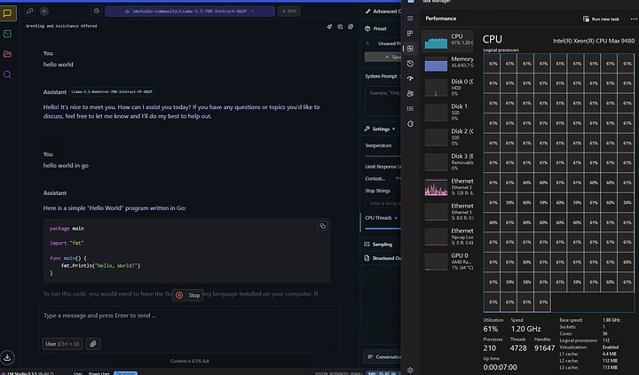

I was able to update the bios and it can get an all core workload at above 1GHz, still not quite fast enough.

I also dont know if the system even detects my ddr5 dimms, is the hbm supposed to be transparent to windows?
