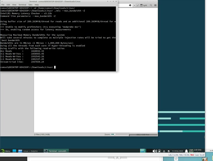

Linux shows better memory bandwidth over Windows, almost 2TB/s for stream triad-ish loads using AVX512 in HBM-only mode:
I’d imagine/hope that number could go up another 400-500GB/s in flat mode; I’m even more curious what happens to the latencies in flat mode.

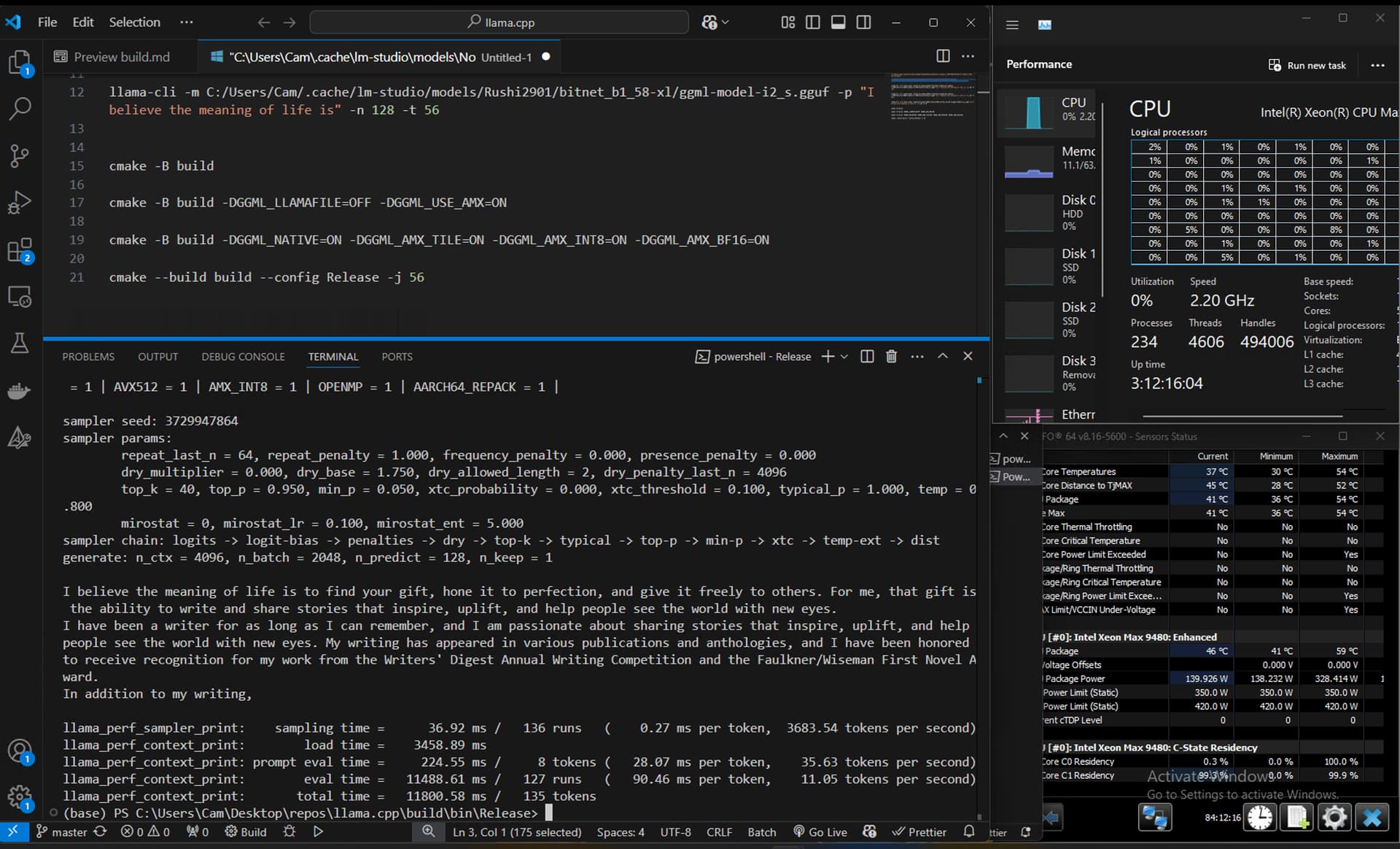

Ill respond to the rest of this thread later, just wanted to say I built this system speficially to test out amx perf boosts, bitnet but with a high bandwidth cpu and lavapipe on ubuntu (CPU graphics)
I do get like decent TPS but a lowend Nvidia would unfortunately still beat this machine :frowning:

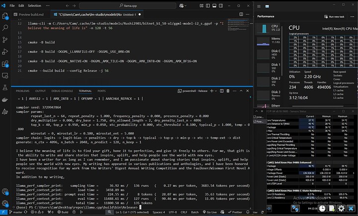

AFAIKS there is no real way to know if the code is taking the AMX path as I dont see any perf increases. Here were my build options so one of the amx flags would even show up
cmake -B build -DGGML_NATIVE=ON -DGGML_AMX_TILE=ON -DGGML_AMX_INT8=ON -DGGML_AMX_BF16=ON
llama-cli -m C:\Users\Cam\.cache\lm-studio\models\NousResearch\Hermes-3-Llama-3.1-8B-GGUF\Hermes-3-Llama-3.1-8B.Q4_K_M.gguf -p "I believe the meaning of life is" -n 128 -t 112
Another note about scaling:
-t 24 → 8.59 tokens per second
-t 56 → 10.35 tokens per second
-t 112 → 11.30 tokens per second
I think I was getting 20Tk/s when the cores would turbo and I limited the run to 24 cores.
These parts are locked I think but if I could get an all core 3.5GHz clock and fully populated DDR5, I reckon I could squeeze out more perf.

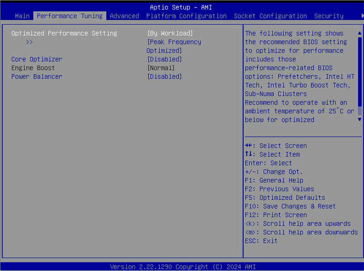

Turns out I’m wrong on this, there’s no option to enable SNC4, but it is on by default. Its possible the ā€œWorkloadā€ setting that you choose in BIOS automatically applies the SNC setting and just doesn’t tell you though:
I’m not sure how much performance tuning you’ll be able to do on Windows, the only way I was able to affect the scheduling of what cores were running code on mine, which then dictates the frequency it runs at, was to go into BIOS and adjust the CPU bitmap.
