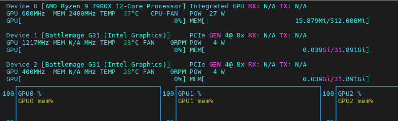

Mine draws 45w in idle. Do you have different numbers or just a different pain tolerance?![]()
Unless nvtop is wildly inaccurate, I’d say somethings wrong if yours idles at 45 watts. By idling, do you mean keeping the vram loaded with a model?
Unfortunately they do idle around 45 watts compared to Nvidia 10w or 15w unloaded.
