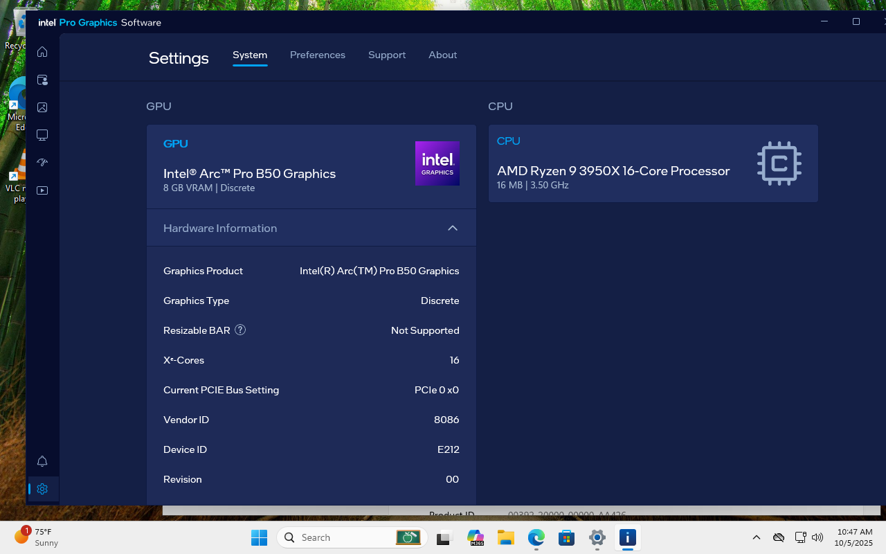

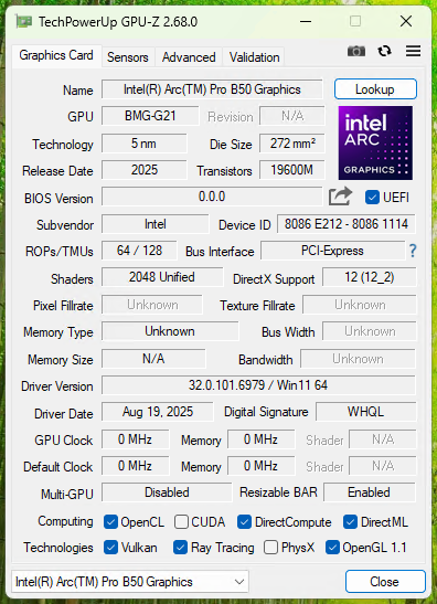

I received my Arc Pro B50 this week and finally had some time to play with it. I’ve got it in an X570 system running Ubuntu 24.04 and mainline kernel 6.17. I created a VF and a spun up a new Windows 11 (25H2) VM in virt-manager with it attached. Once Windows was booted I installed the Q3.25 driver (32.0.101.6979) and… it works? Here’s the Geekbench GPU score, which seems about right. Unfortunately it doesn’t look like video encode/decode is working; I see high CPU utilization and the GPU perf view in Task Manager shows 0% video decode and processing. We’ll see what kernel 6.18-rc and the Q4.25 driver bring, but this is a heck of an encouraging start!
Other notes: I cannot get the host stable when booted into Windows. The display goes dark and as far as I can tell it’s kernel-panicking. I was able to capture “Stop code: VIDEO_TDR_FAILURE (0x116) What failed: igdkmdnd64.sys” using another GPU for display out. Speaking of which, I also seem to hit a major snag when I bifurcate the PEG IOU. It will still boot to Linux with it set to x8x4x4 or x8x8 but I completely lose display out. Disabling SR-IOV doesn’t help but I didn’t troubleshoot any further than that. I suspect Intel support won’t be too keen to work with me to fix this on AM4. :expressionless:

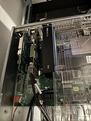

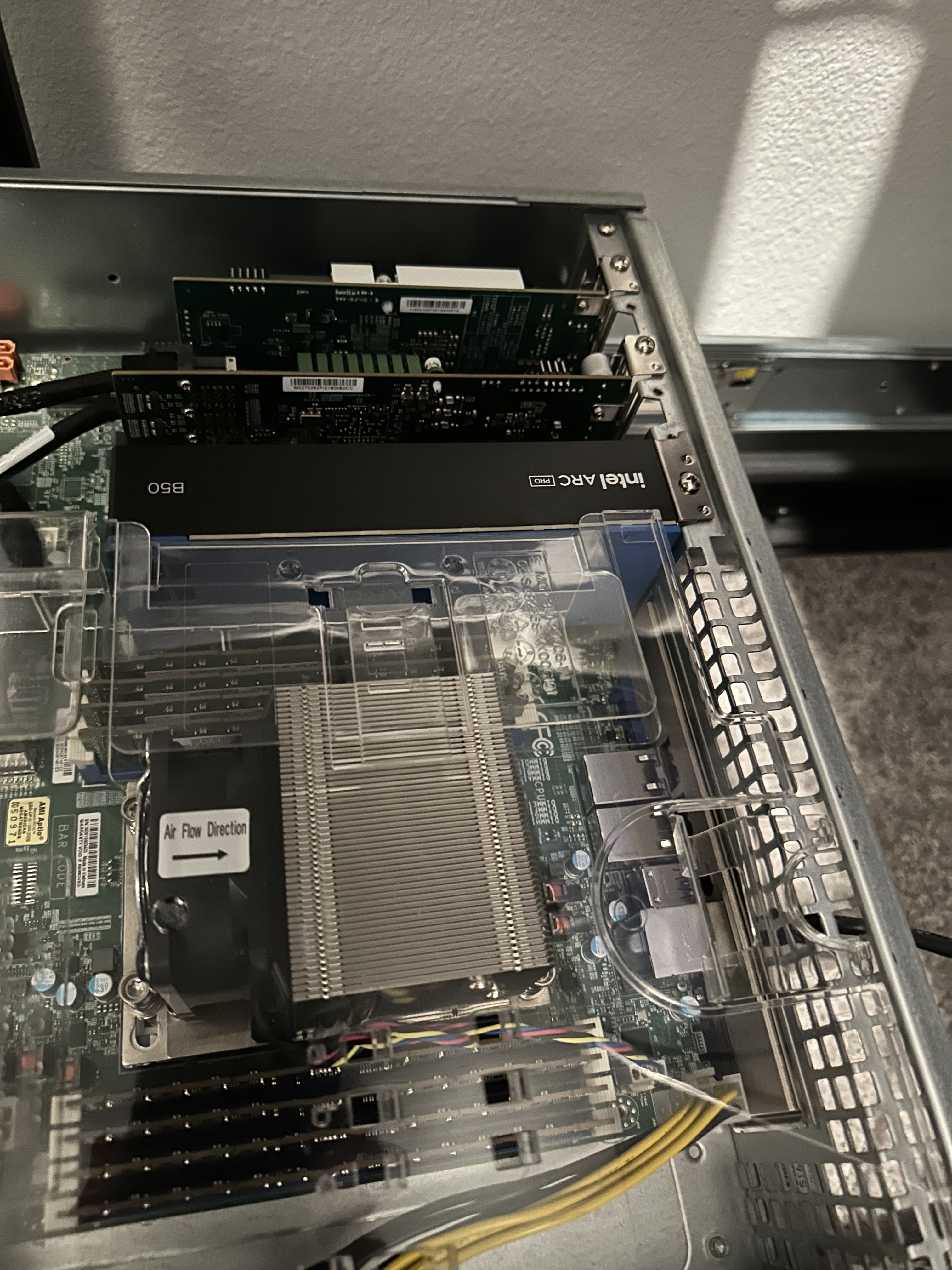

So i’m two servers down installing the arc B50’s and on my HWE kernel 6.14 - the B50 isn’t supported which is to be expected.
On the 6.17 kerel from Ubuntu’s kernel repo I can get the B50 to be recognized, but yeah no SR-IOV joy.
I know my servers support SR-IOV - they are ASUS RS700-E11-RS12U’s and my Mellanox ConnectX-4 25G NIC’s are showing SR-IOV support and VF’s from lspci - but no joy on tthe B50 :frowning:
I’ve put in a support email to ASUS, but no real joy as of yet. I also can’t find anywhere in the BIOS to forcibly set the PCIE link speed on these ASUS systems which is incredibly frustrating.
