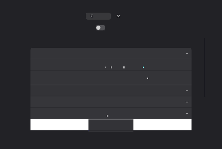

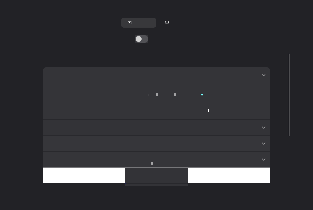

I have issue with Bazzite in Arc B580 GPU. Whenever I move a window, it shows an afterimage of it and the texts became square. Worst is when I open ProtonPlus app, it became a white mess, even without doing something with it. Not sure where or how to try to solve this.

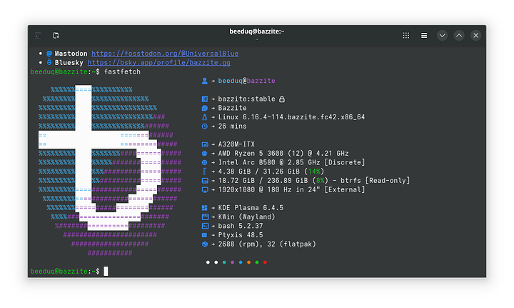

Kernel version: 6.16.4-114.bazzite.fc42.x86_64 (64-bit)

Screenshot of ProtonPlus. Lol
My system.

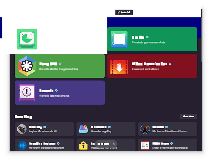

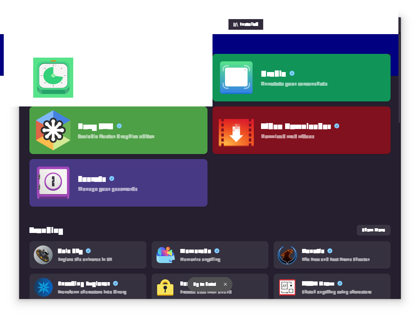

My Bazaar. I’ve not tried to open all apps, but some do work, like Lutris and Steam.

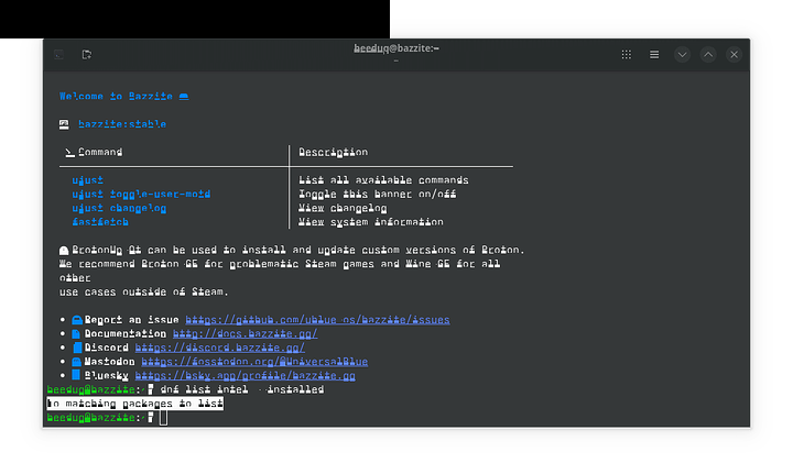

dnf list intel --installed
This will tell us what you already have installed. Arc cards no longer use the i915 driver, so we are looking for xe or some intel-specific mesa package as Abub said.
It returns with “No matching packages to list”
It’s getting worse. Lol

Welp. I have moving on to CachyOS, since every options at Bazzite were “it’s already installed” when searching for the solution. Even Bazaar refused to load.
And Bazzite is immutable, so trying to figure it out with limited help from online and Intel being so new in Linux makes difficult to try to fix my issue.
