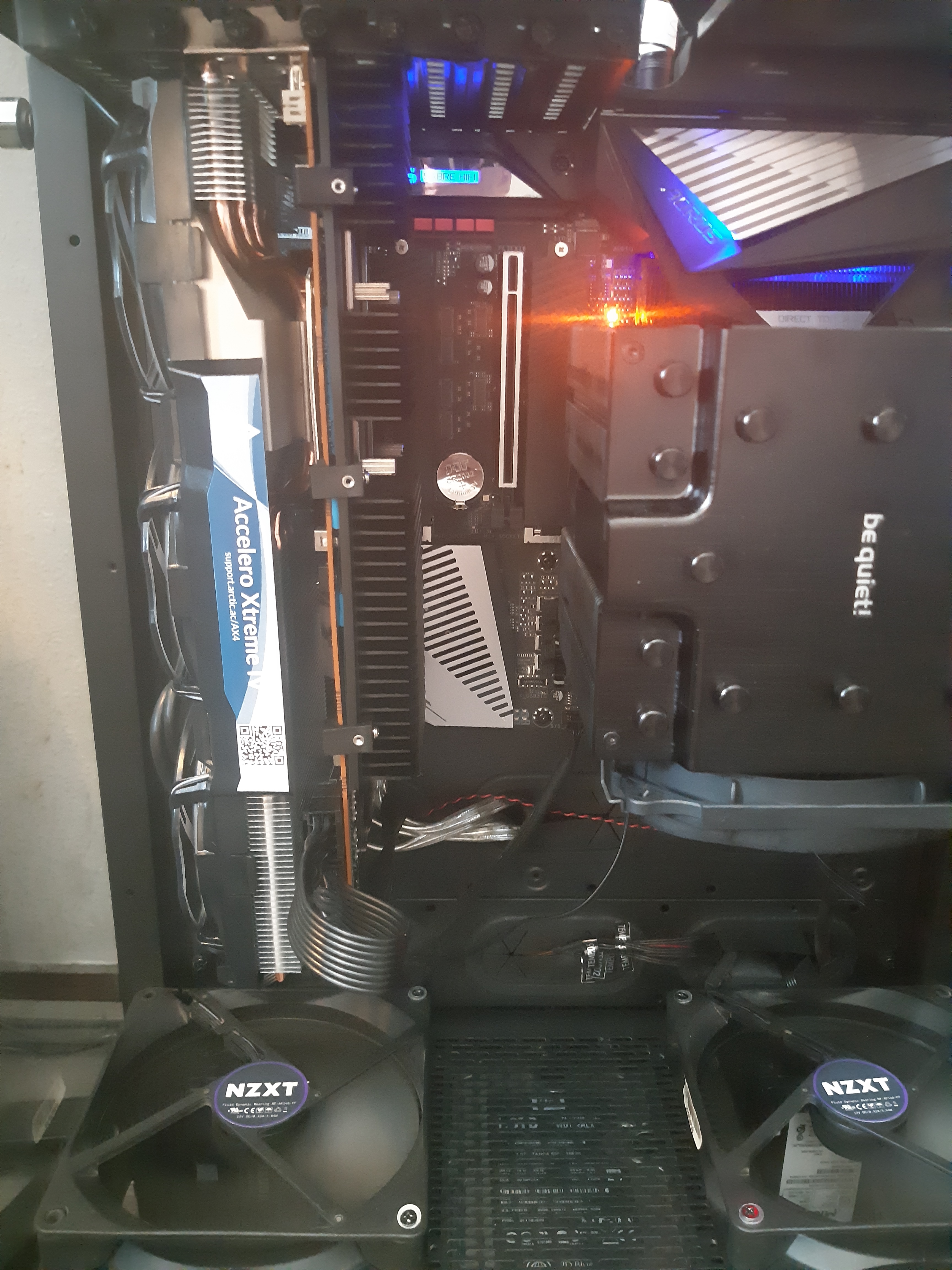

The problem is not the fan side it is the back side, that black heatsink is that thick that if you use a Dark Rock Pro 4 or Noctua D15 the black heatsink on the back can’t pass the heatsink of the CPU coooler.
With the fan side and the black heatsink on the back your video card becomes a 2,5 slot card.
You should be able to move the GPU to the other X16 or X8 PCIe slot and not suffer any performance loss…
Also yeah, those hyouge aircoolers are sometimes pain to fit… Especially with that Accelero…
I had to install it in the second slot, see picture.
If you look closely, you can see that you don’t have enough space when you put the card in to the first PCIe slot, my Dark Rock Pro 4 is to big. Maybe watercooling this CPU and you don’t have this issue.
