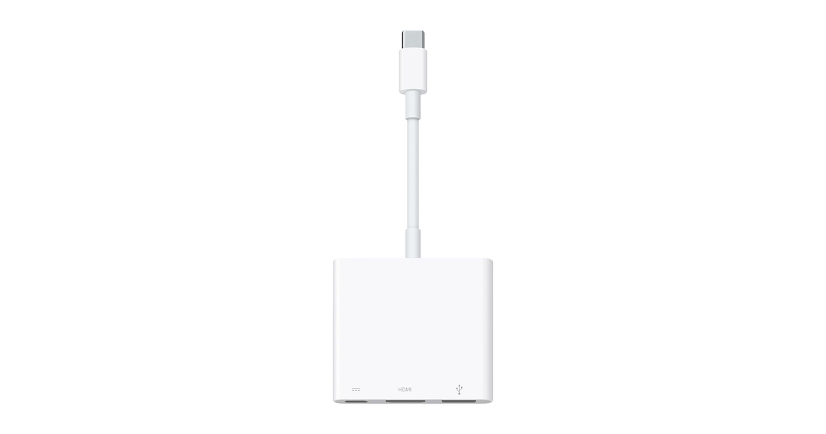

hdmi dongle that worked the best is the hdmi multi port from apple.
i doubt any adapter under 100$ will get you true 120hz hdr 4k on type c via hdmi.
the multi port adapter charging is poop and more to keep high powered usb devices going on that adapter
i dont think i need this for my problem unless there’s something im missing here. the apple adapter seems like a choice. i also saw this DELL adapter but i have no idea if its compatible with apple products… probably not i guess Dell USB-C to HDMI 2.1 Adapter | Dell USA . i have more faith in dell than some chinese bullshit from amzn like CableMatters
