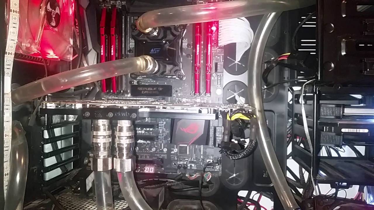

I think my pc died HELP-!
So I think my mobo may have shat on me..
Any ideas?
No post
code00
no beeps
Im stuck with my cellphone till this is fixed

Its an x99 so no gpu equal no screen
But the led bios indicator never leaves status 00
This says CPU

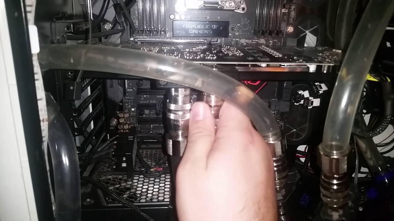

Koolace qdc non drip my ass

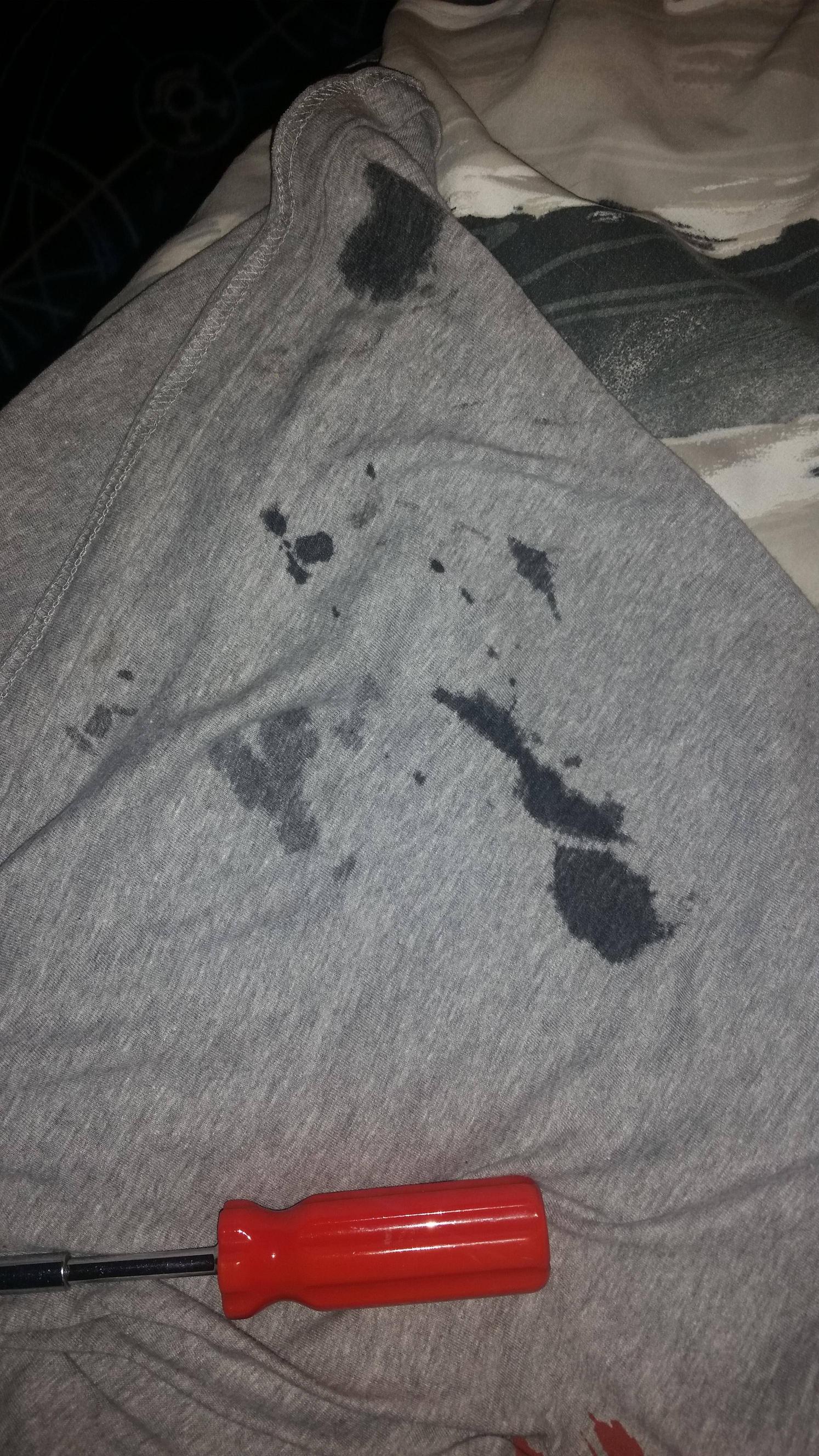

Unplug 2 qdc to renove the cpu block and it shoots jizz rite on the back of my gpu
Used my shirt to dab it dry
I cant seem to locate any dual bios type switch
I will have to CPU out in a minute to test booting the board with nothing attached is a code other than 0 0
No ram no cpu boot test
Qdc is usefull
But did drip…

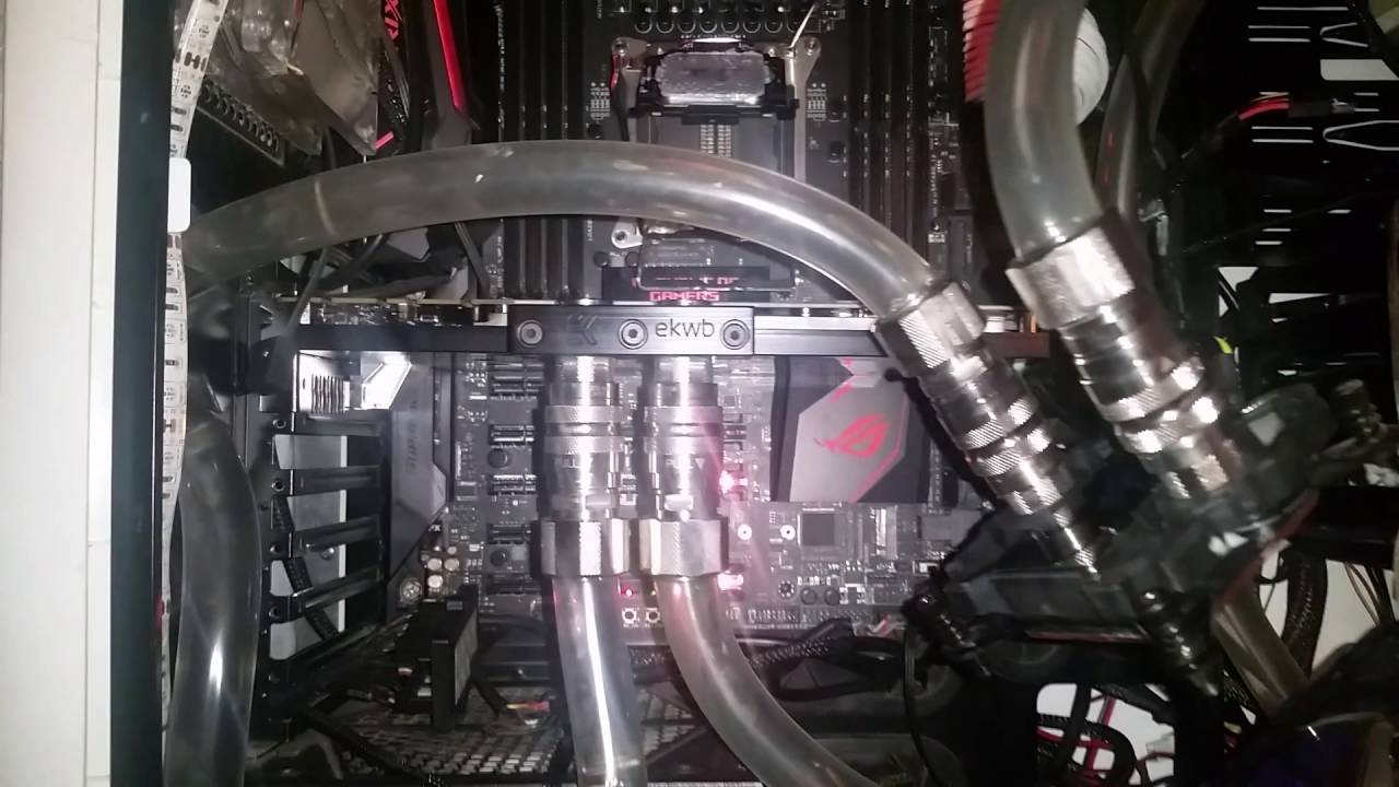

Update,
Put the cmos battery back in
Put gpu bacl in to see if the monitor wouls kick on
Tried to boot
Held finger against the cpu to check for temperature
No screen
No post
No beeps
Code 00
And it felt like no change in cpu temperature
Have you inspected your loop/motherboard for leaks? Seems weird it up and died. I’d be looking for burn marks or damaged componentry at this point.
