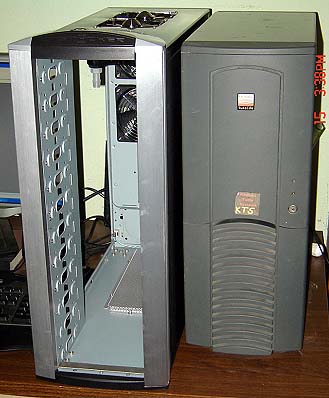

edit: Is this a photo from the internet or actually your case?
If this is your case, you have the answer to why you’re having a temperature problem.

Janos it is just a crazy photo from the internet not of my setup.
gal2
My setup looks like the one to the left with raid bay inserts except for the 2 fans in the top, I have only space for 1 (again this is not a pic of my setup but only an example). I may have to actually snap a picture of it, and stop being lazy.

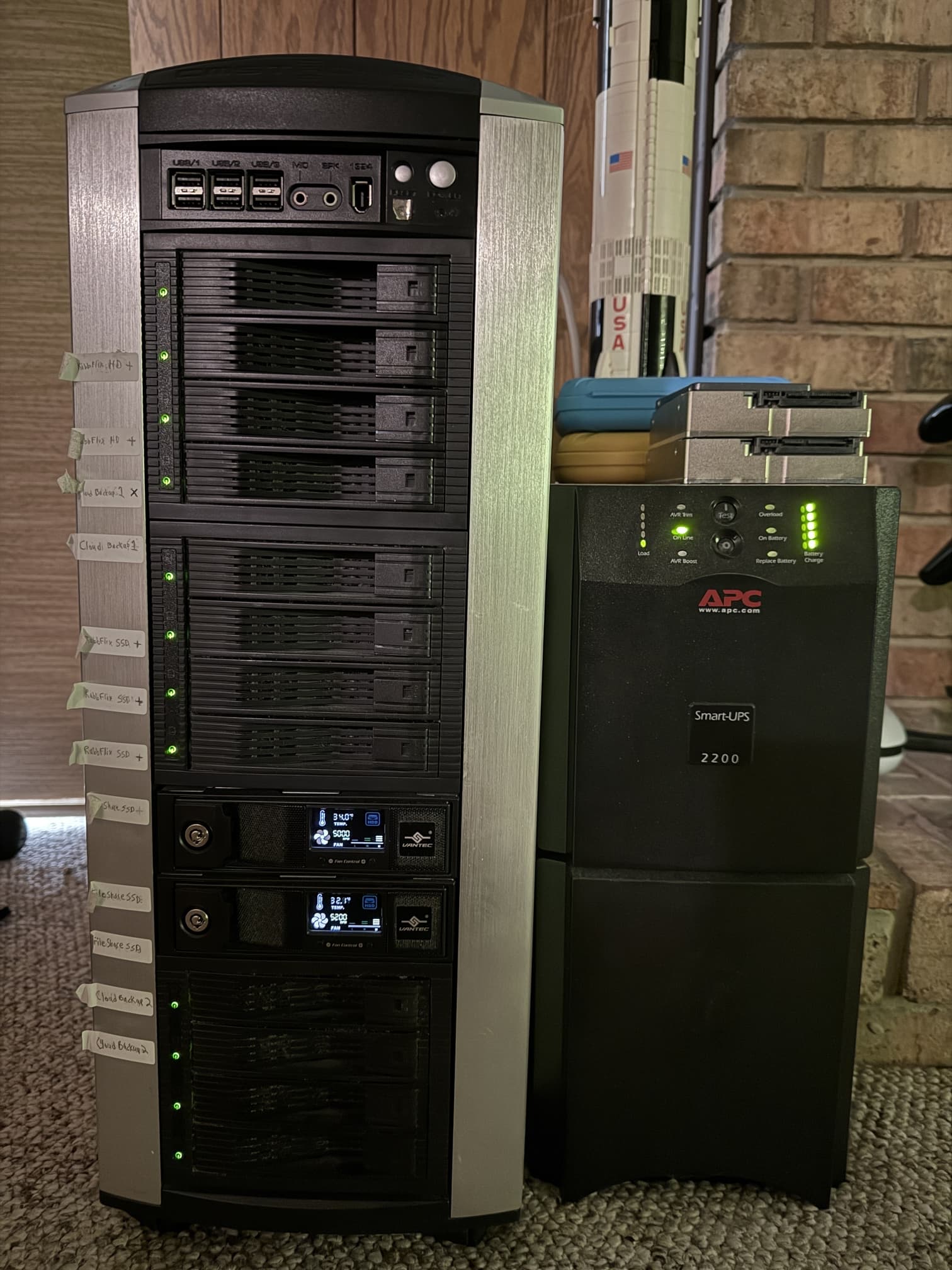

Here is a pic of the old dog :slight_smile: LOL
I like this case! + SSI EEB to boot. Thanks for the recommendation. I think I buy cases every 20 years LOL… but do not mind paying a good price for something sturdy that will last.
The case is still a beauty, was the best design at the time

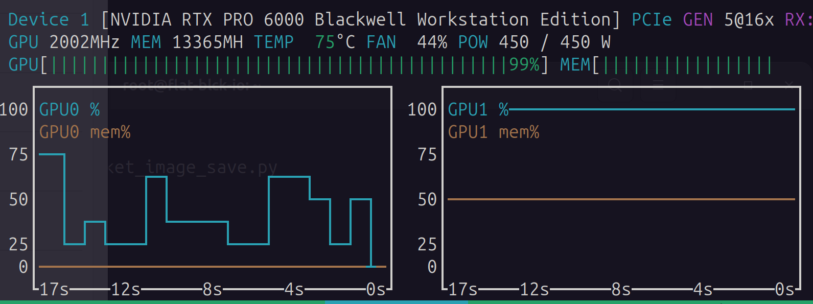

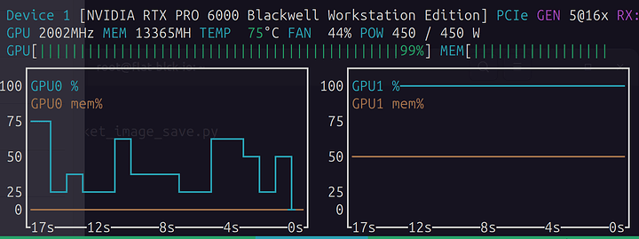

+1 to case issue
Hammering the card at 450w it is around 75-77c in my case

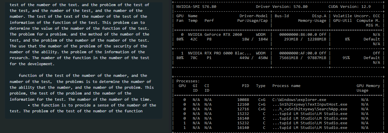

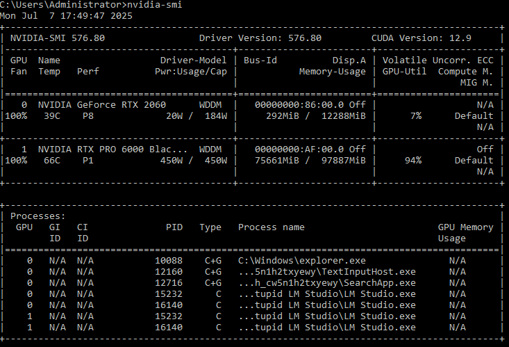

I did a test ramping up the fans to 100% via MSI Afterburner, and 66C-67C was the range for me at 450W with 93%-95% utilization. I will test dialing this back since it does sound like a wind-tunnel now to something that will keep me around your temp but not sounding like I am taking off.
BTW 44% fan speed, I wonder what the fan curb looks like for you before it ramps up. It was not 100% speed for me even when it hit 85C. Strange.
This is at 80% fan speed temp between 75-79C. 16.97 tok/sec 10354 tokens. The run was about 15-20 minutes until EOS.
