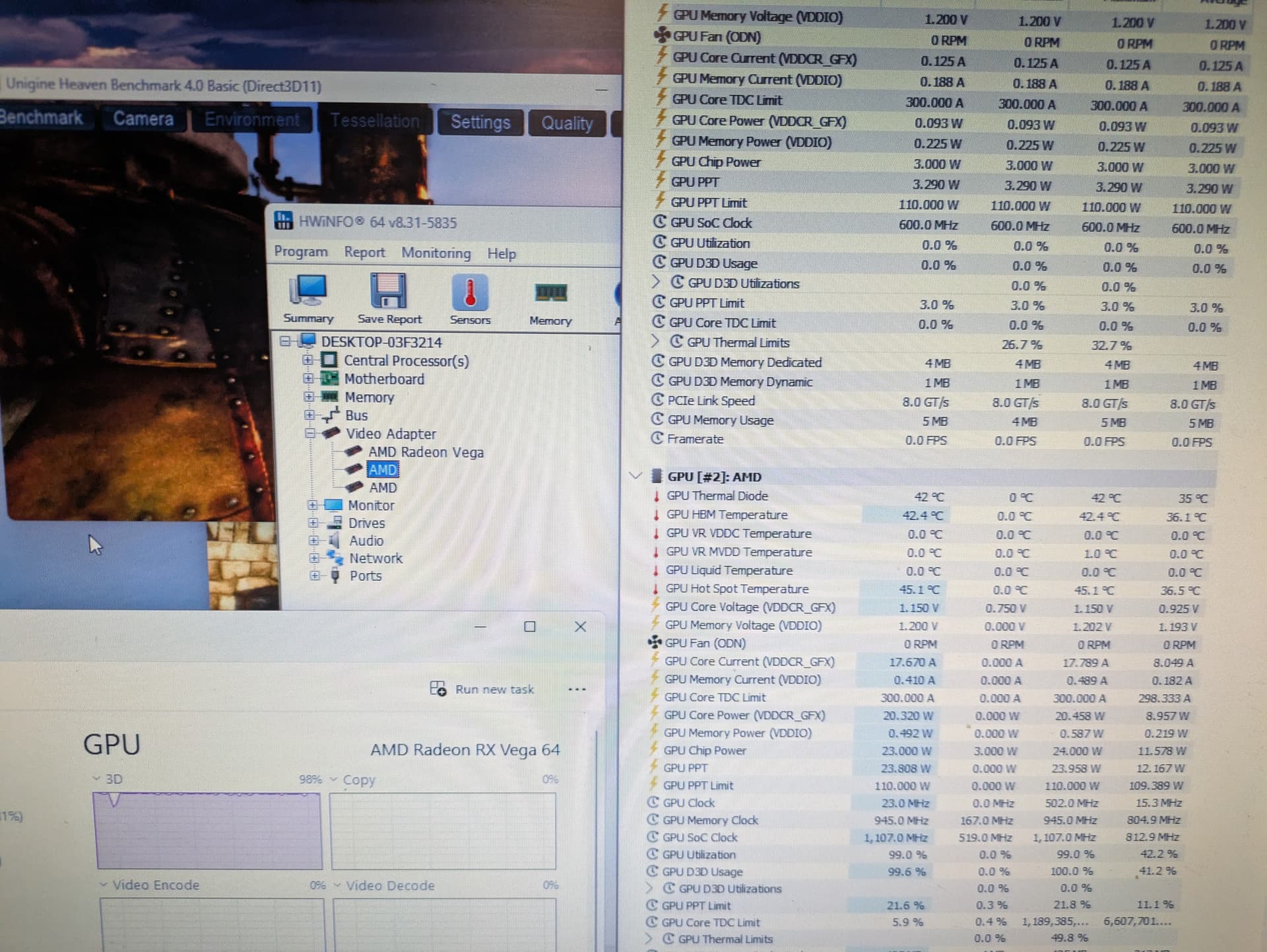

Did you check HWInfo64 for power draw information and GPU utilization? Maybe youll find something interesting like only 50w draw or no utilization on 2nd GPU.
The card basically refuses to use more than 25watts per gpu it’s clocked at 23Mhz wtf (the limited power draw was something I saw before when I was on linux running rocm, so that’s a big clue)
What does it say, under “GPU thermal limits”? Starting to look like power problems, for sure.
That image is from while you are running a GPU load? Cause it basically says you are not using your GPU more than a couple percent. Though it could be reporting problems since quite a few areas show 0 for some reason, probably due to the specialized nature of the card.

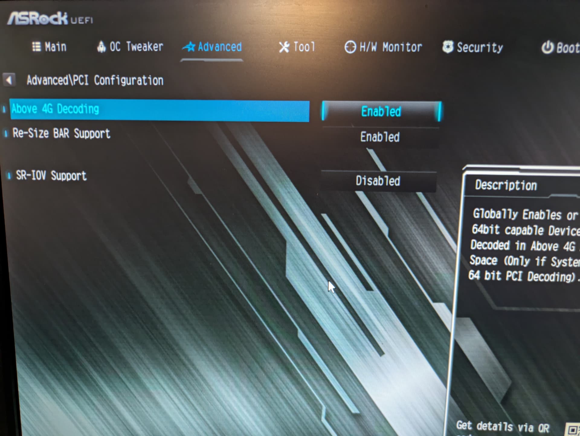

Do you have Above 4G Decoding and Resizeable BAR enabled?
My systems are ancient and all have a switchable BAR, so they just… do it when required. But on new ass stuff you can hard lock it on and get the full bus all the time. This is really important for stuff like Looking Glass and VM Swapping GPU’s, so I bet its just as important here.
In 2020 I tried to build a machine that would let me use GPU’s sorta like USB sticks for VM’s. Didn’t work out, 3900X was a huge kack and a half with no RMA option for my use case, so I threw the whole thing out, but the only way the cards even showed up correctly and ran anything at all was Above 4G Decode and ReBAR.

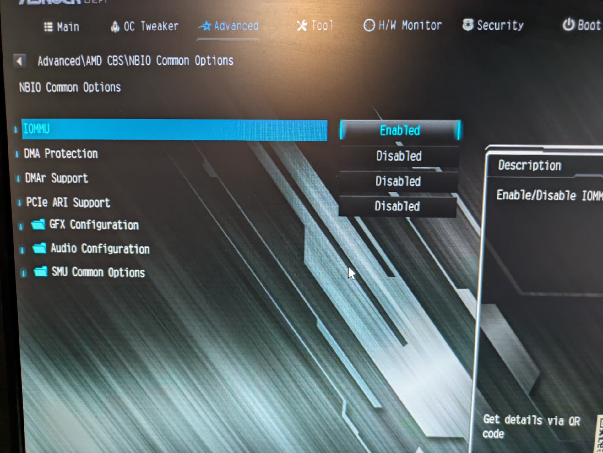

Also that sounds convenient for getting these weird cards booting which does require some bios tinkering. Could the board have some bad power delivery or something that’s preventing it from leaving the low power state? Or do you think it’s significantly more likely that the driver, not having all the information available is preventing it from going to a higher power state? I’m going to try to flash it later if I can’t get it working as is.
Turn IOV on too.
I think its just about the PCIe chips talking to each other in the right modes. IOV in GPU’s will kill this problem in future.

Yeah, it works and all but it’s stuck at a core clock of 23mhz, memory clock looks fine though. I haven’t found anything that has helped yet. Not afterburner or clockblock :frowning:
sounds like a hardware issue, power sensing is probably broken ( card will put it self in a low clock state to protect itself). usually it is repairable, if you lack the expertise to repair it, I would probably just chuck it, buy another one if you feel lucky.
