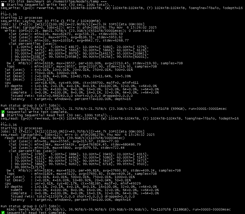

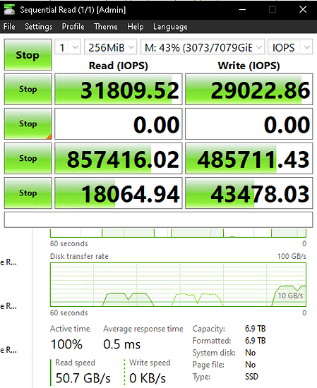

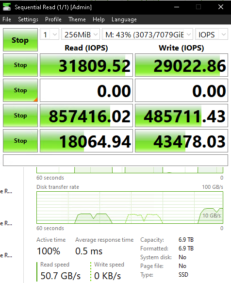

So, to give you a reference, I used to test enterprise storage arrays. Circa 2016 I was testing an NVMe storage device back before consumers had their hands on NVMe at all. I had written a little 10MB program (10MB was its runtime memory usage) that could push 75GB/s. yes, big B, to this storage array entirely with asyncIO. The array was supposed to do 100GB/s, but they never got the firmware where it needed to be in order to actually get 100MB/s. The project ended up getting scrapped because it was CRAZY expensive.
You’re right, if you’re issuing 4k reads/writes to storage, you’re going to get ass performance. Internally, the smallest unit of addressable memory is anywhere between 128 and 512kb. Most consumer chips I’ve seen are 256k. Meaning if you write or read any less than 256k, the controller is reading or writing 256k to the physical chips and just giving you the smaller bit you asked for.
Knowing little facts like that is why I was able to get 75GB/s out of a program that used less memory than a smartphone app.
Oh, and before you ask, no. The data was not all 0s or some other easy to predict pattern. The data was completely random. To the point that deduplication and compression algorithms couldn’t touch it. But I was not CPU bound, because, again, I understood what the hardware was doing, and I understood how much ‘random’ I needed to send to get the drive to work a certain way. On modern storage, with 4k sector sizes, you only need to change 1 bit (I did 1 byte; faster) every 4k bytes. This is how you can make TB/s of random data with minimal CPU overhead and no caching will be able to cope with it. Think I’m joking? Try it out.

I went down the whole zfs stripe across a bunch of gen5 nvme devices trying to get the performance I needed to load huge models into trays of GPUs. It was meh.
Then fell down the rabbit hole and started patching the actual inference engine and libraries… I got about a 4x performance speed up here. The limiting factor was how the code read the file and wrote to the GPU in series horribly inefficient.
Then I gave up and did what all insane infrastructure guys do. just jam it all into ram on boot and load from there:

Short answer is my NFSoRDMA nic is only 100gig so im reading from stable storage at 10GB/s give or take. I just parallel rsync all the files at once and it moves very quickly.
Putting storage inside the inference rig itself seemed unnecessary when I could just use external disk I already had shared out.
If you want I can FIO test to the shared disk tho. Its a pcie gen5 stripe in zfs.
The storage box only has a 12 core xeon so its a little bottlenecked on processing power.
my workstation has way more cores so I used the VROC m2 stripe in there to run this:
