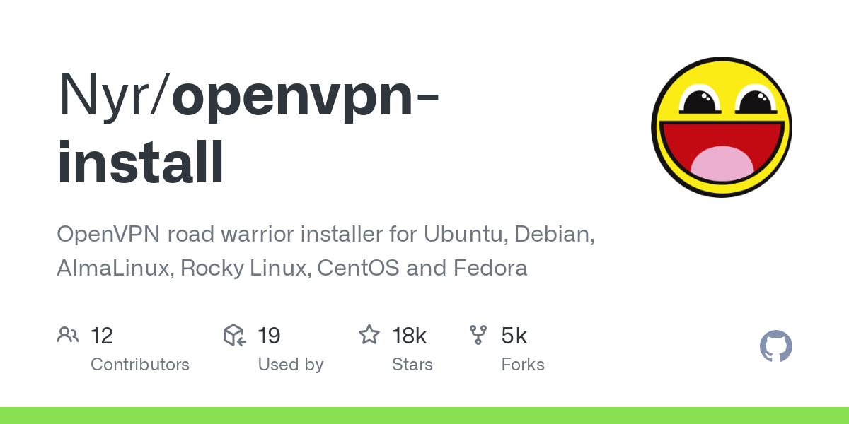

  • OpenVPN-Install Script by Nyr is the one I used for my setup:
  • However someone forked and created a enhanced version of the script, which you can also try out if you want to:
    https://github.com/angristan/openvpn-install
