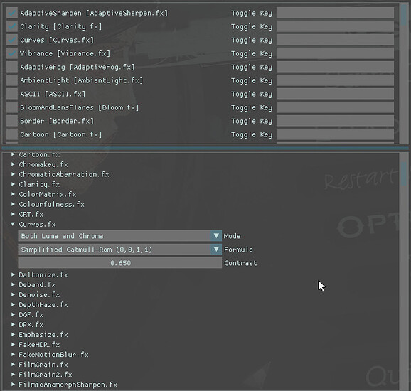

Installing and Running Reshade
First go to https://reshade.me/
Then click download.
Run Reshade Setup Exe
Click Select Game. Find the Game .exe file that you want to install ReShade for.
Your game will likely use Direct x11. So select Direct3d 10+

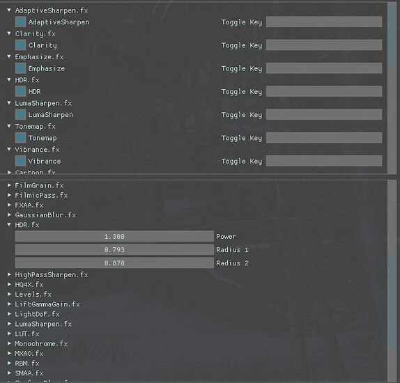

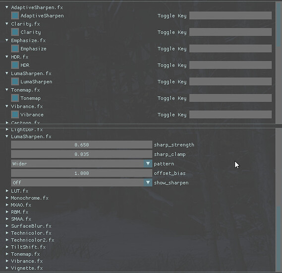

Select the Shaders you want to install. I recommend installing only the following for starting off:
AdaptiveSharpen
Clarity
Curves
FakeHDR
HighPassSharpen
Levels
LumaSharpen
Click ok.
Launch the game.
Get into the actually game.

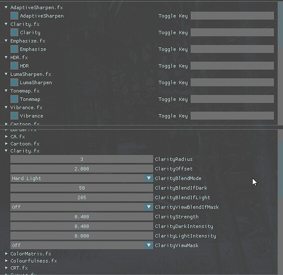

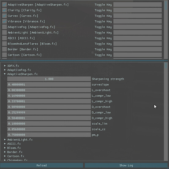

Press Shift+F2
Press the plus sign
Name the ReShade Preset
Click the boxes of the Shaders you want to apply
Click Apply
Then adjust.
Adjusting the numbers you click and drag with the mouse left to decrease, right to increase.

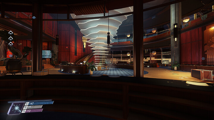

Prey 2017
Curves
FakeHDR
Levels
Sepia
Before ReShade
After ReShade

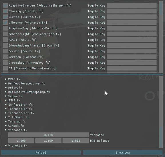

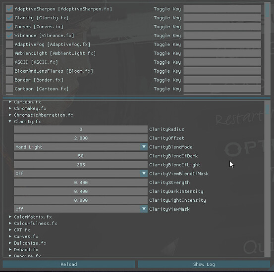

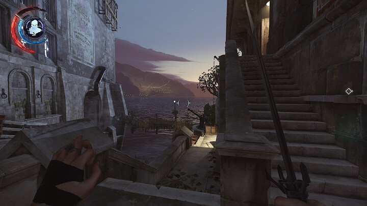

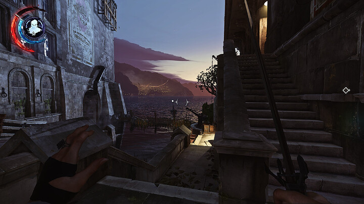

Dishonored 2
Adaptive Sharpen
Clarity
Curves
Vibrance
Before ReShade:
After ReShade

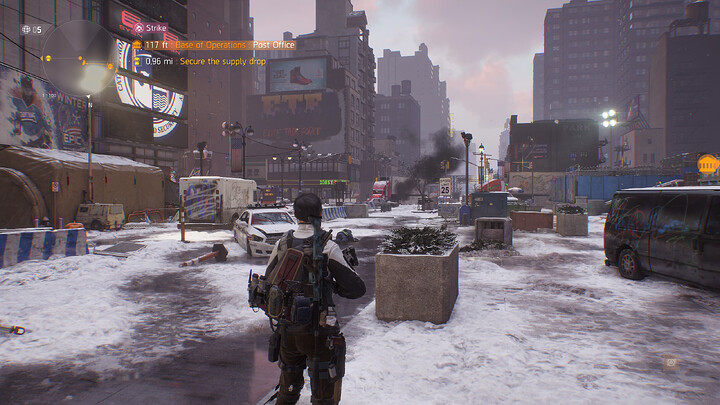

The Division
Note - Change the setting for bringing up ReShade to Shift+F3. Cause Shift+F2 The Default for ReShade will bring up Uplay.
Curves:
Levels:
Before ReShade:
After ReShade:
The Division is one of my more minimal ReShade Presets but it does make the game look better than base.

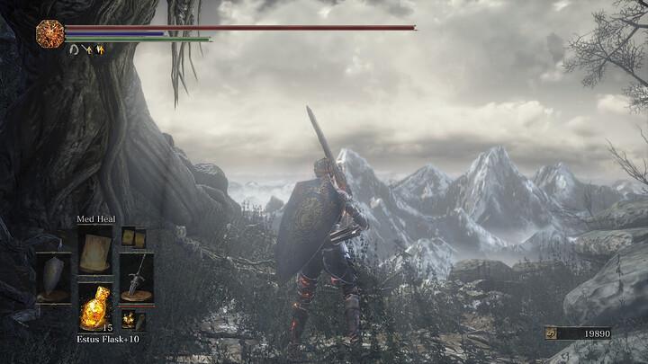

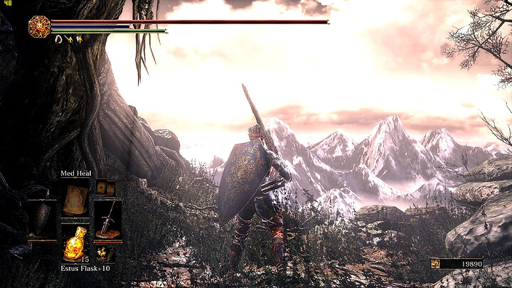

Dark Souls III
Adaptive Sharpen:
Clarity
Curves:
Fake HDR:
Levels:
LumaSharpen:
Tint/Sepia:
Before:
After:

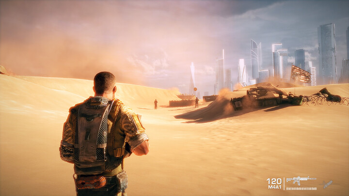

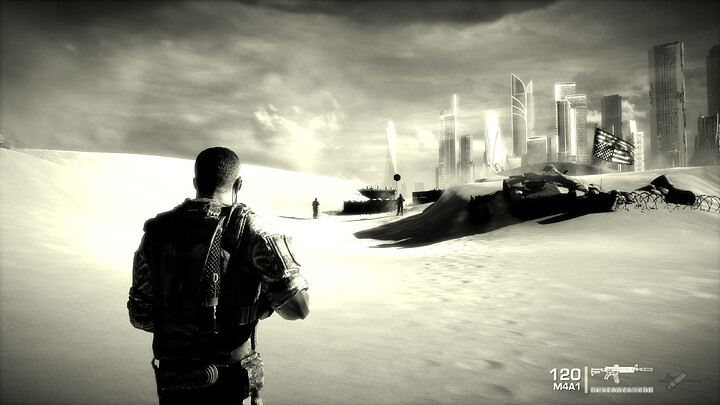

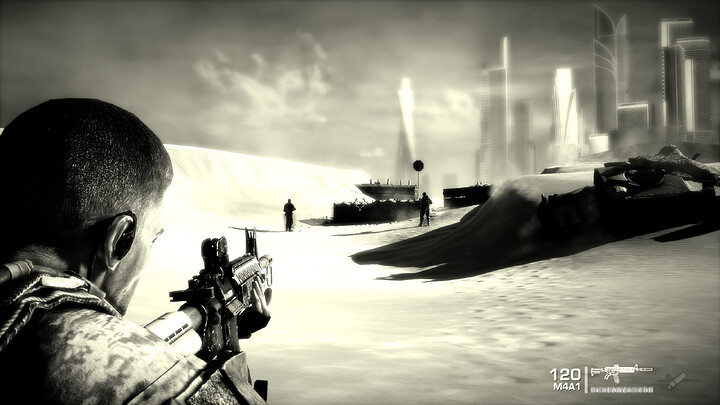

Spec Ops The Line Black and White Preset
Note 1 Spec Ops The Line EXE is found in the binaries folder in Win32:
Note 2 Select the Direct X 9 API for ReShade when you install it to Spec Ops the Line.
Curves
FakeHDR
Levels
Monochrome
Tint/Sepia

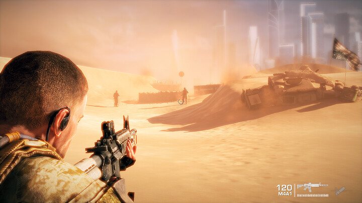

Before ReShade:
After ReShade:

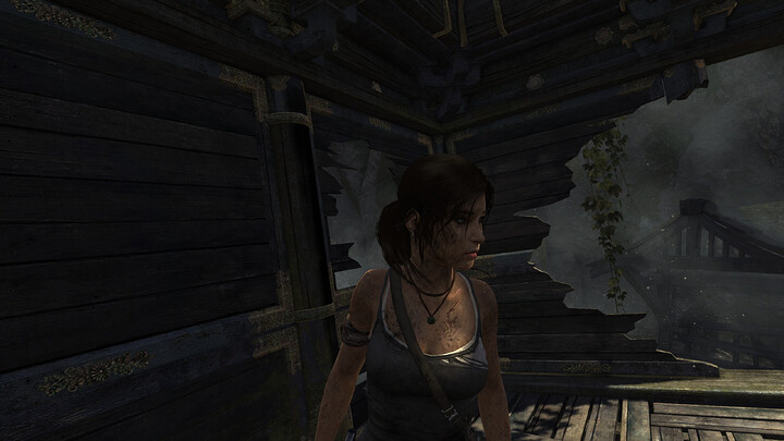

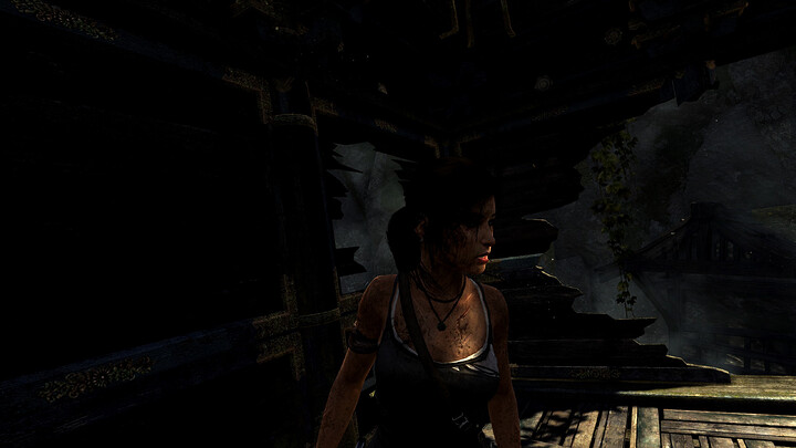

Tomb Raider 2013
Note on this Preset even though I had Tint initial I don’t use it after seeing how it looked. So I didn’t include the settings for it. It is also not featured in the after ReShade Screenshot
Curves
FakeHDR
Levels
Before ReShade
After ReShade

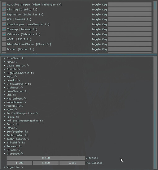

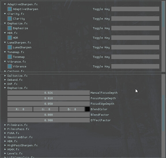

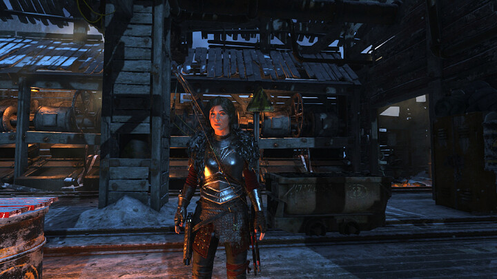

Rise of The Tomb Raider
Adaptive Sharpen
Clarity
Emphasize
FakeHDR/HDR

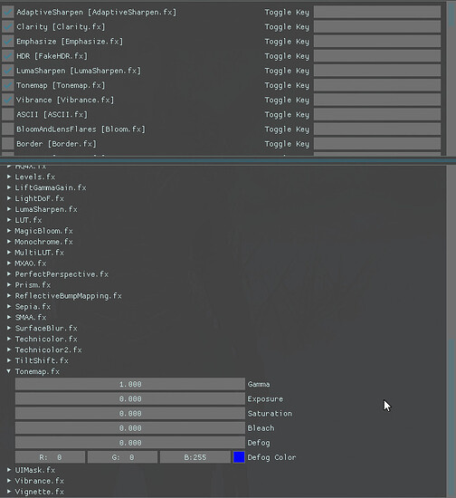

LumaSharpen
Tonemap
Vibrance
Before ReShade
After ReShade

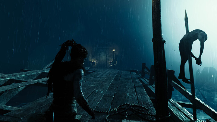

Hellblade Senua's Sacrifice
ChromaticAberration
Clarity
Curves
HDR/FakeHDR
Levels
Tint/Sepia
Before ReShade
After ReShade

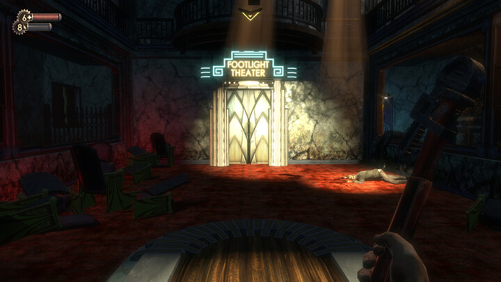

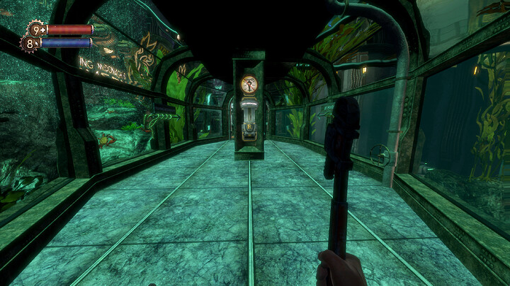

BioShock/BioShock Remastered
This Preset can be used for both the normal BioShock or the Remastered one.
Note 1 Select Direct X9 API when installing ReShade for BioShock or BioShock Remastered.
Note 2 LOCATION of the BioShock .exe for the normal BioShock:
Note 3 LOCATION of the BioShockHD .exe for the Remastered BioShock:
Note 4 You need to change the Overlay Key for ReShade because Shift brings up a menu in BioShock and BioShock Rematerd. I suggest Z cause it isn’t used at all:
Cartoon
Curves
FakeHDR
Levels
Tint

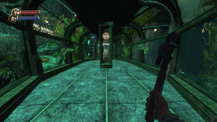

Before ReShade BioShock:
After ReShade BioShock:
Before ReShade BioShock Remastered:
After ReShade BioShock Remastered:
