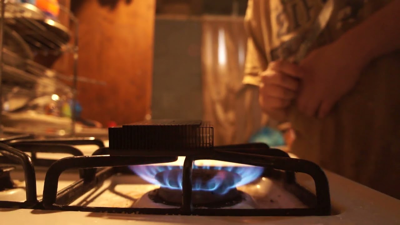

Other than the VRAM baking itself, decent enough. I’ll either add another fan, or more thermal pads, or both. The cold plate stays hot enough that I don’t think thermal pads to it will help the VRAM. The 40mm VRM fan running off 5 Volts is acceptably noisy.

How bad was gettimg that heatsink to mound to the vapour camber
The M40 has thermal pads on the back. Give me a minute and I’ll upload a video how I removed the fins; it was pretty easy.
Aye just curious on how they soldered it to the plate and if you look at the adapter I listed you could just put the heating you’re using on it as well instead of the aio and job done

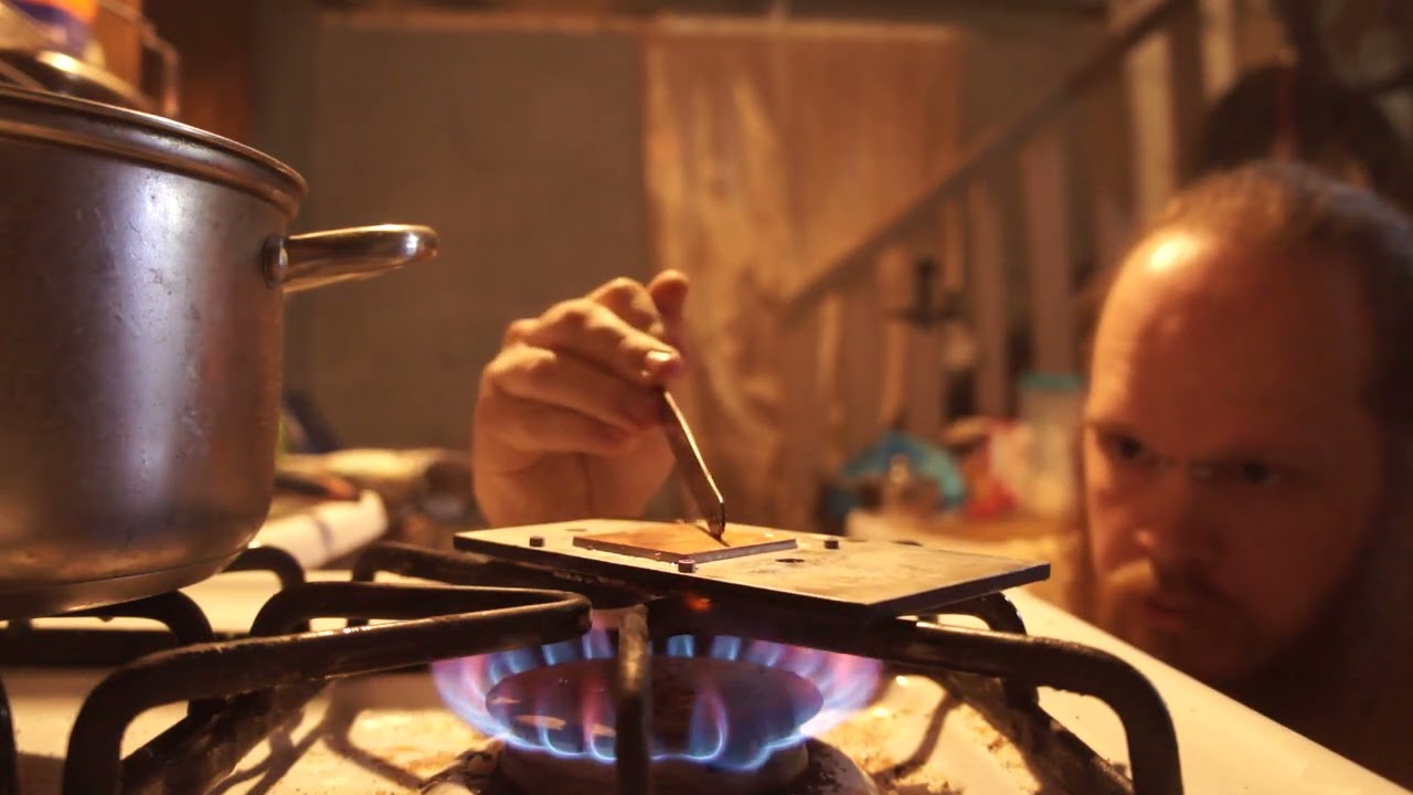

I’ve soldered many heat pipes, many failures; i usually hear a hiss when they fail. I may add some of the solder back to fill gaps, maybe throw a copper sheet over that. I just desoldered then sanded what was left; it could certainly be better contact. Also, I wouldn’t expect the plate to get so hot so quick if they weren’t working.

I got you and yeah might just be the gap I did have a thought maybe you’re just cut up the fins to give clearance to the heatsink and once you’ve filled th pipes back in just solder the cut up fins back on and that should work

I popped the heat pipes.
Then replaced them with copper plates.
It seems to do a little better now; ambient might also be lower though. I think the extra thermal pads would be enough to make me happy.
It sure helps.
