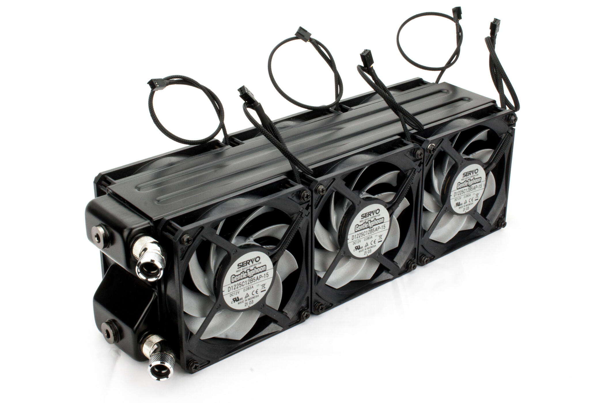

Currently I’m looking at the XSPC RayStorm Ion EX240 kit:

The plan is a 240 in the front and a 120 in the back, and that’s about all the S340 supports. I believe I can get a 280 in the front if the fans are mounted to the case, otherwise the rad will interfere with the I/O at the top. I might lean that direction just to get up to 400mm of surface. Can’t really go any thicker than standard though just due to the cable management bar, which I don’t intend to remove.

You would probably be alright with a 45mm thick 240 in the front if it has high FPI count but you’ll need fans with good static pressure to push the air through and you might need to increase the rpm on both the pump and fans. It sounds like you would be alright with that because it would probably still be quieter than running the stock gpu fan at 3000 rpm.
