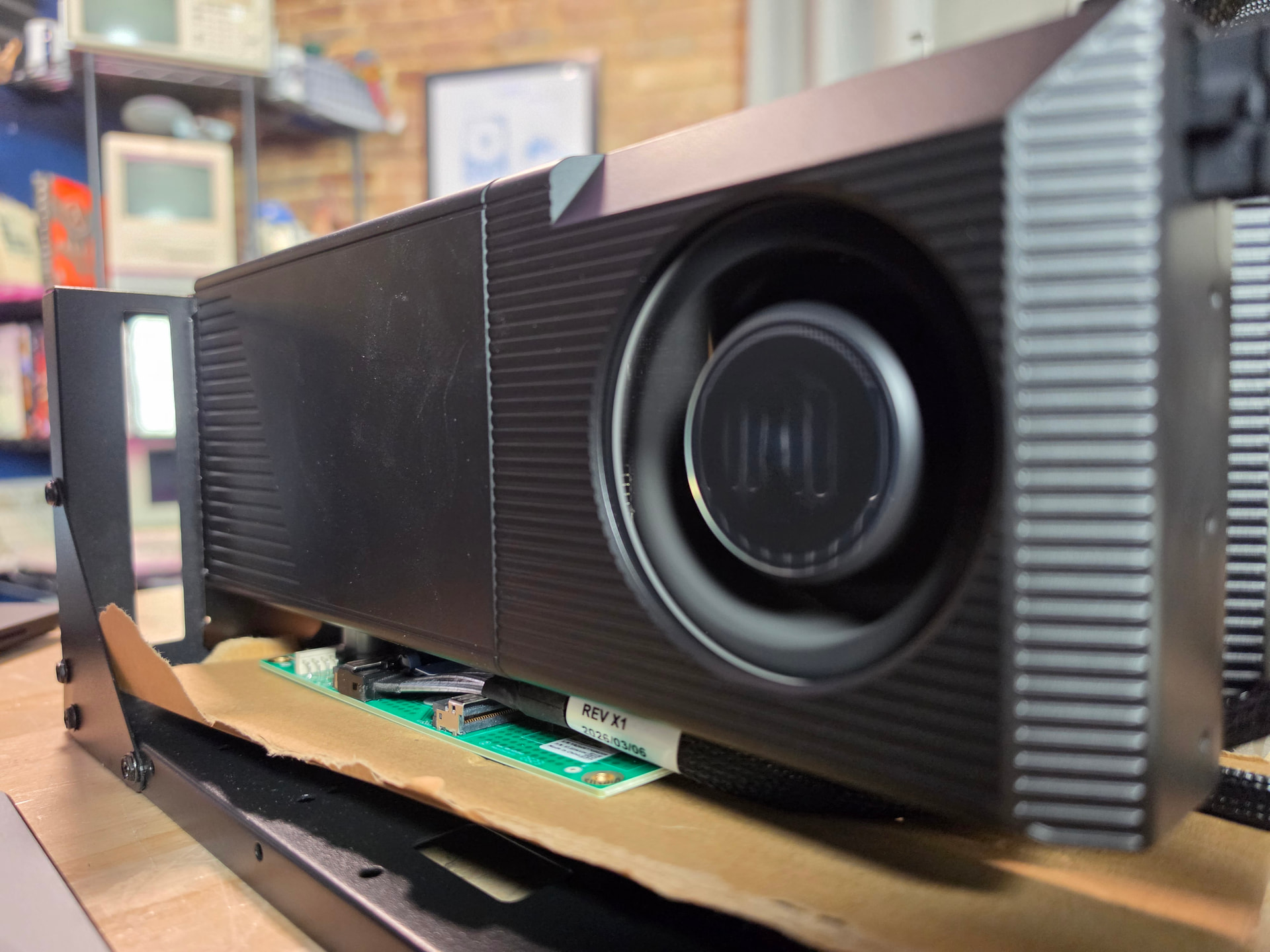

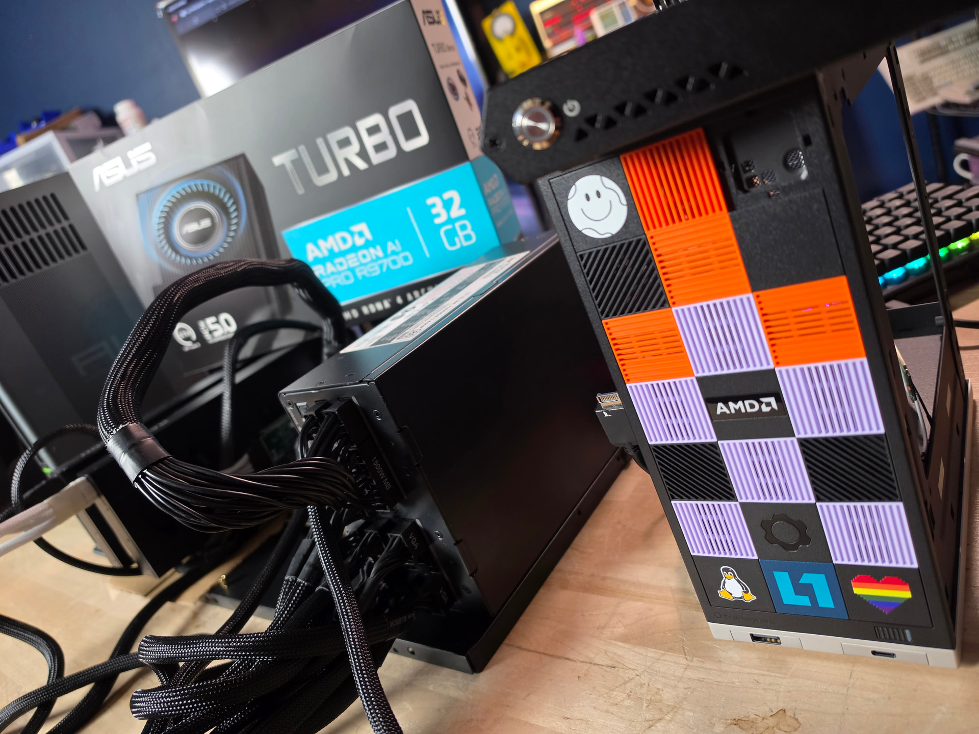

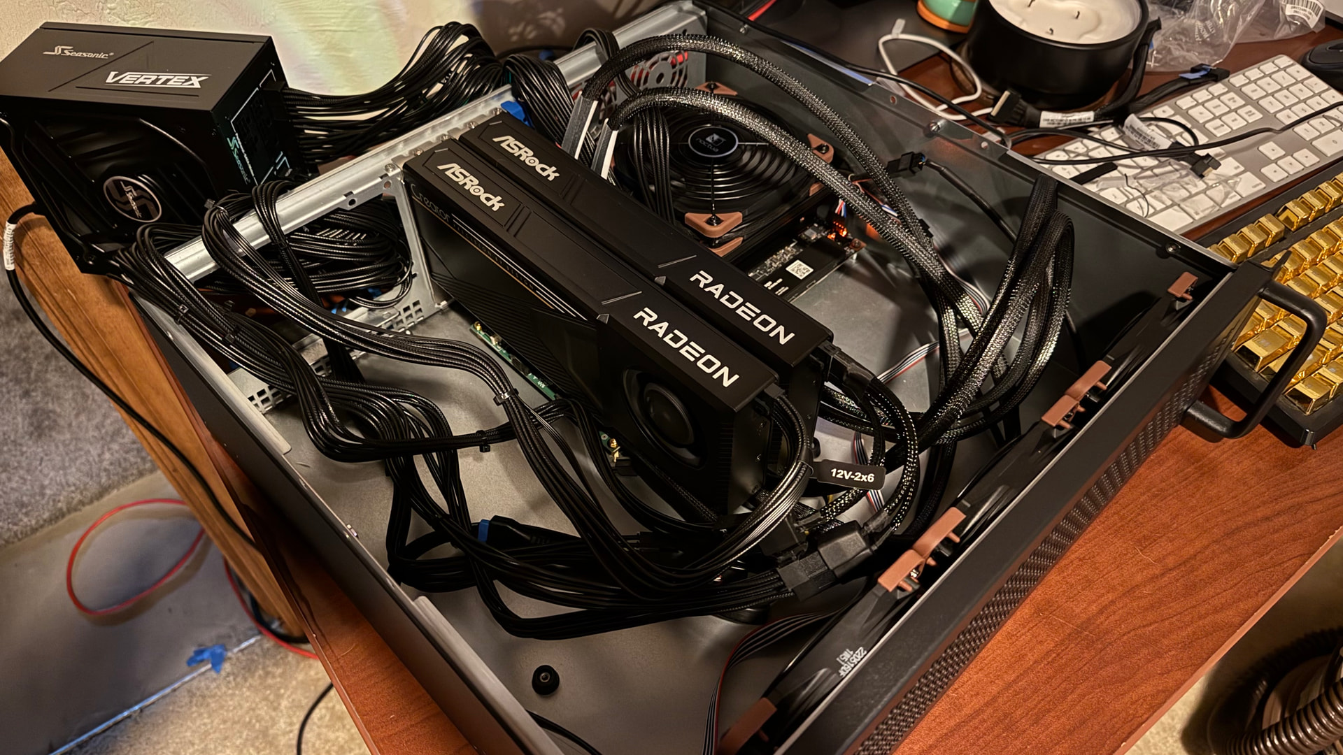

1. What Was The Config
The machine (what hardware works)
  • Strix Halo APU: Ryzen AI MAX+ 395, 128 GB unified memory, Radeon 8060S iGPU (gfx1151) with ~112 GB exposed to the GPU as GTT.
  • 2x AMD Radeon R9700 (gfx1201), 32 GB each, attached via an external PCIe switch.
  • CachyOS, kernel 7.1.x, ROCm 7.2.4, llama.cpp built for both GPU architectures.

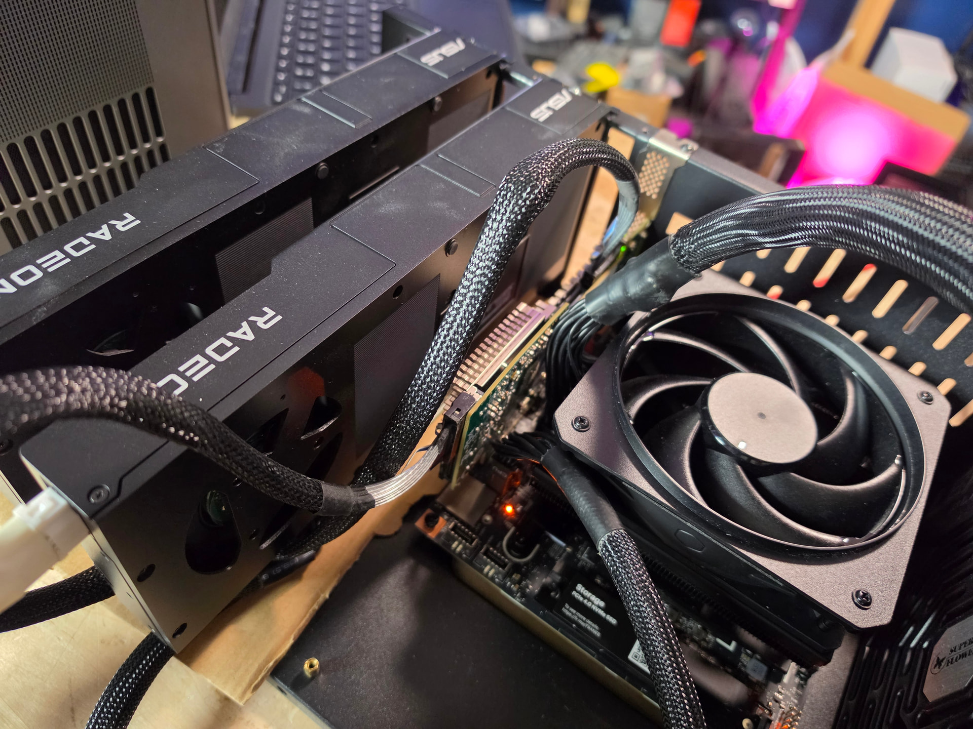

Note: It’s basically become impossible to find Pcie 5.0 PEX/PLX bridges, but you can still pick up PCIe 4.0 bridge cards on ebay. NOTE These are not the same as a Pcie 5.0 redriver/retimer. With the latter the platform is responsible for lane bifrucation.. i.e. you need a 16 lane slot configured for x8 x8 to get two x8 x8 slots. Here it’s a true bridge and that’s something different.
Here is a pcie 4.0 version of the PEX. Note these are different than bifrucation adapters. This is a true pcie bridge. 88XXX chipsets are gen 4, 89XXX chipsets are gen five. Also pay attention to the connectors. These are slim-sas style connectors and MCIO are modern connectors. You can sometimes find Pcie gen4 cards that have mcio connectors – those would be preferable to the connectors in this ebay listing.

  1. Only one R9700 was visible. The second GPU’s memory BAR failed to allocate the external switch’s memory window had been consumed by the first GPU, so amdgpu never bound the second card. The machine was effectively 1x R9700 + iGPU, which defeats the whole premise.
    Fix: pci=realloc on the kernel command line.
  2. A load storm after that reboot (load avg ~39). Both R9700s and the switch ports had entered runtime power management and then failed to wake D3 to D0 transitions failing, devices stuck in resuming, wedging the display path, hanging KDE, triggering a KDE restart loop plus kworker/khugepaged CPU storms. Not a fork bomb, but it sure felt like one.
    Fix: amdgpu.runpm=0 pcie_port_pm=off.
  3. A kernel Oops on every GPU memory alloc/free. Signature: general protection fault at amdgpu_vm_cpu_update, reached through svm_range_validate_and_map. It crashed torch and HIP, and HSA_XNACK=1 didn’t help. Root cause (from source analysis): an amdgpu.vm_size=128 override on the command line, combined with the RDNA4 GPU’s 57-bit virtual memory and the CPU’s 4-level paging, produced a pathological page-table geometry that exposed a use-after-free in the page-table allocator.
    Fix: remove amdgpu.vm_size=128 (back to the default). Zero faults across the entire benchmark session afterward.
The full working command line ended up as:

Just finished the video on the frankenhalo and made an account here to share mine. About a month ago I bought 3x Radeon Pro V620 32GB for $350 each on eBay (people have since woken up and they are now double that).
Framework Strix Halo 128GB in a 3D printed 10” server rack
Connections:
V620: PCIe Oculink adapter to minisforum DG1
V620: M.2 to Oculink adapater (with redriver) to minisforum DG1
V620: Thunderbolt to an old Razer Core X TB3 enclosure
Believe it or not this unholy mess is completely stable. I have let it code an entire android app over night. Hours of unsupervised development have already been done. I have ~224GB of memory for what feels like pennies.
I am running DS4-Flash-0731 UD-Q3-K-XL at 400K context using the Nathanwr1014 fork of llama.cpp (apparently i can’t share links here?)
Note on that project: they originally hyper optimized it for DS4 and it really does work. They have since moved on to hyper optimizing for the latest Qwen models so I’m using a version a couple of versions ago.
Off the top of my head benchmarks for agentic coding:
At deep context of ~200k:
TG: about 20-30 with Dspark
PP: about 120-140
Very very usable. I could actually fit an even larger quant of DS4 and even more context but this is a multi user household and I’m serving smaller faster Qwen 3.6 35b at Q6 265k context at the same time.
Here’s a snippet of my launch .sh file for the llama.cpp parameters and the Vulkan tensor split:
