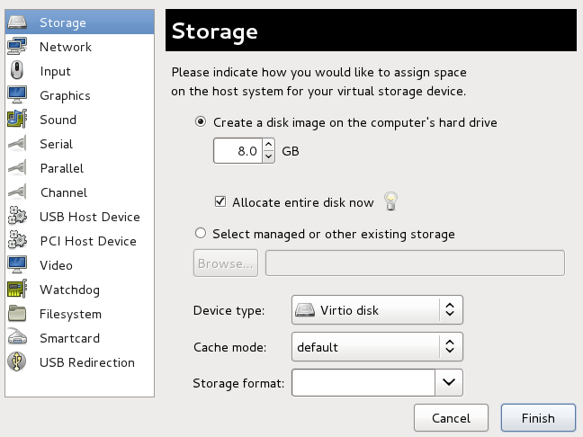

Your libvirt XML does not seem to be using a virtio-scsi disk controller - this is needed for iothreads to work. You need to add a scsi controller in virt-manager & set your disks to use it.
Thanks for the help so far!
I added one SCSI controller, a small VirtIO drive and started the VM.
Three unknown devices appeared in Device Manager:
2x SCSI-Controller
1x PCI-Device
I then installed Balloon, viostor and viocsci drivers for them.
I could also install the NetKVM driver to my network adapter.
I checked every Hardware ID to install more drivers as listed in the article below. Without luck.
So those four drivers were the only ones I was able to install.
After that I restarted, changed my boot drive to VirtIO and changed my config.
