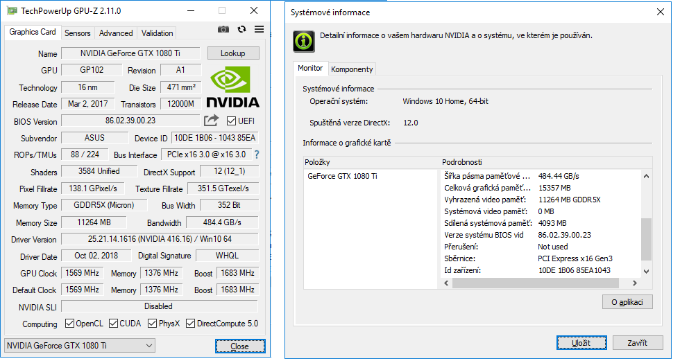

Thanks. I had to add void pcie_negotiate_link(PCIDevice *dev); to pcie.h.
Nasty patch is working, CUDA bandwith test without changes.
screenshot
https://www.monitos.cz/tmp/nasty_patch_PCIe3.0.png
