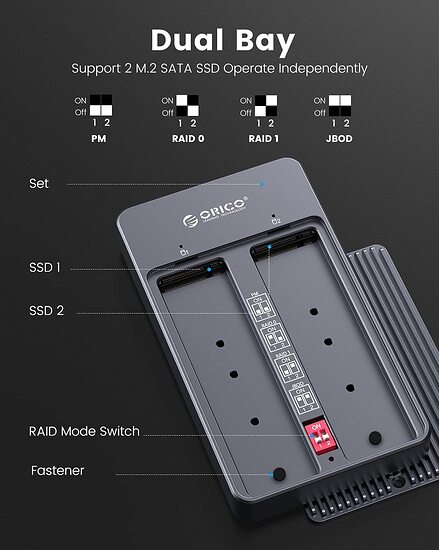

I have been using a pair of Intel D3-S4510 SATA SSDs from ebay in this USB-C dual bay sata raid enclosure. Setting it to RAID 1 Mode, I installed windows 10 on it via Rufus’s “Windows To Go” option so I can have a portable windows install for testing things/benchmarks/whatever.
  • After disabling hibernation and messing with some power options to keep it from being shut off during sleep, it’s been working solid for over a month on my laptop. So far power loss (pulling the plug) seems to be handled gracefully.
  • My SSDs do have PLP. Not sure how something like some 860 evos would handle power loss.
  • I haven’t tested moving it back and forth to different systems yet. I expect what will happen is something gets confused and I’ll need to reboot 2-3 times.
  • I have not yet iterated through seeing how it handles losing a disk. Naturally I also have daily backups setup on it especially since I’m actively using it as a desktop right now.
I had initially considered dual M.2 sata, but those things were really pricey for decent sizes when last I looked, and it made more sense to go with traditional 2.5" sata.
This also has a JBOD mode which is actually what I want for the future. It’s so when I feel the need for self harm I can experiment with setting up either ZFS or BTRFS storage on windows, so I can have real data corruption protection, not just outright hardware failure protection.

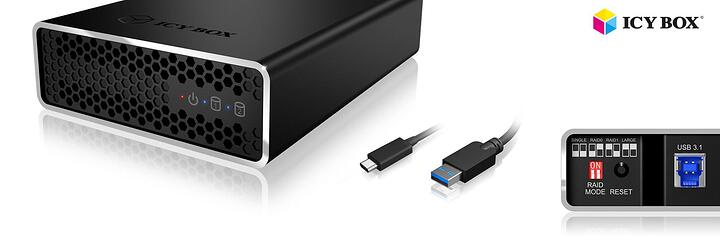

https://www.amazon.de/ICY-BOX-Externes-Festplatten-Aluminium/dp/B01BHR3VPA
This looks interesting. two 2.5 ssd, raid1, usb3, the price is rather acceptable, the size is a bit large but still within the limits of mobility…

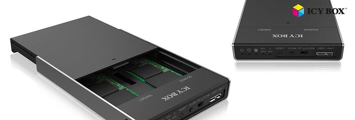

You can quite actively automate this with the right software or a couple of scripts. But if you want something totally automatic, there’s a dock with full disk cloning.
You go to town with disk A, disk changes happen, you come home, you put disk A in the dock and you put disk B in, press “copy” and the contents of disk A are copied to disk B (erasing everything), end result you have two disks with the same content.
The same can be achieved simply by using two drives attached to the PC and one of the many backup programs.
