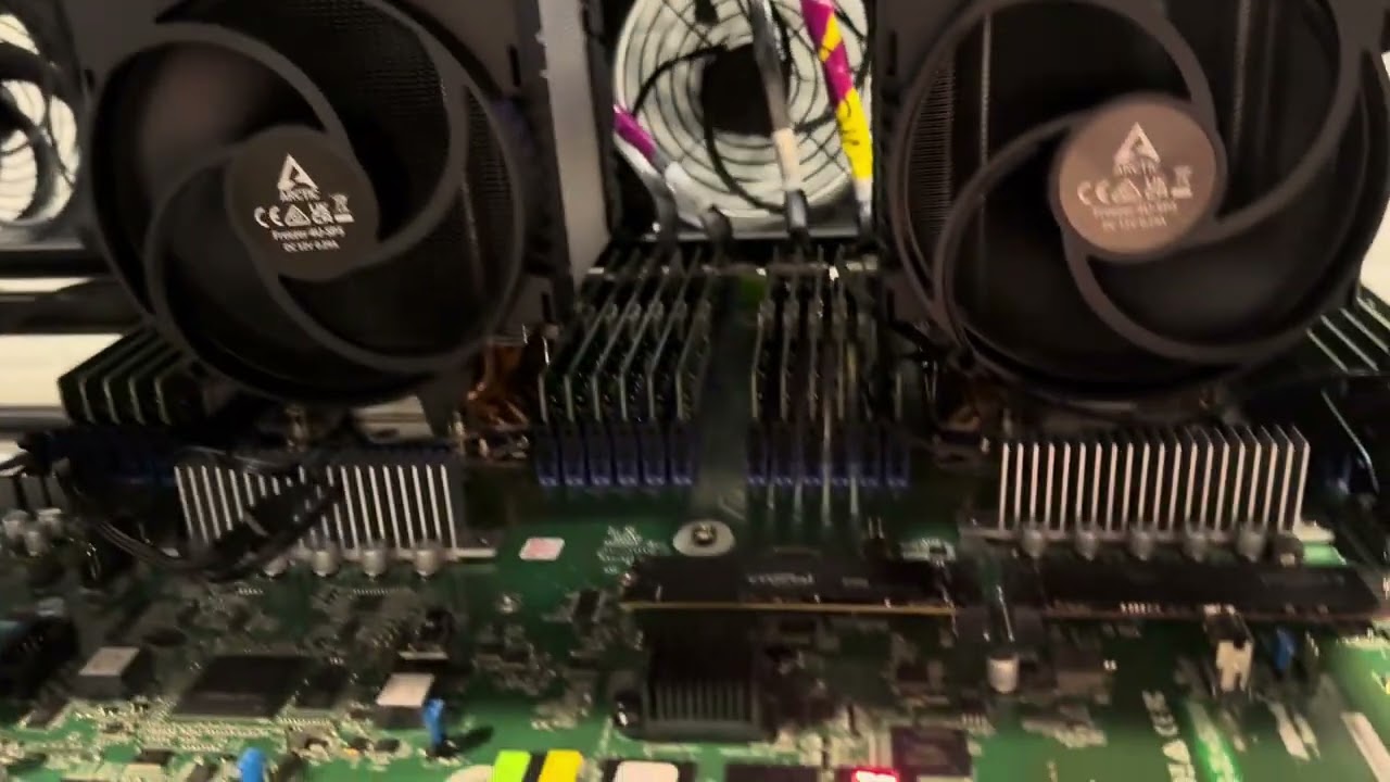

Its worth mentioning the MCIO numbering is out of order and cabled kind of flipped where mcio 4 goes in the first 0-7 lanes and mcio 3 goes in 8-15 so you end up cabling 4,3 then 6,5 then 8,7… assuming you are leaving the mcio config x16 in all the bios options.
I have run x4x4x4x4 for storage and x8x8 for NICs, and x4x4x8 in one weird case, simultaneously with the x16 GPUs.
Appreciate the pics etc, yup all done as I have done in the past with the genoa board inc the odd to even on ports. So Asrock gave me a new BIOS, it allowed it to post but over 4 GPU and in a world of hurt still. Genoa boards worked OOTB, Turin, nightmare,
