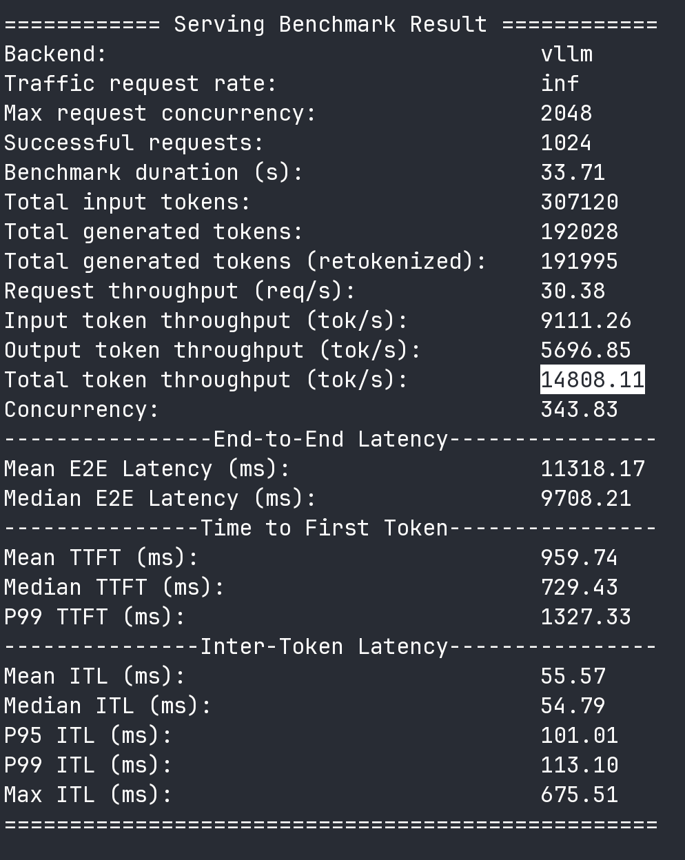

What running vllm/sharegpt bench looks like with llama3-8b and 4 x RTX PRO 6000s going full tilt:

Perhaps you may be interesed in knowing that there are ongoing efforts to port that board to Coreboot: Thoughts dereferenced from the scratchpad noise. | Gigabyte MZ33-AR1 Porting Update: PCIe Init, BMC KVM Validation, and HCL Improvements
@lhl did you make some benchmarks with an 32b or 70b llm? I’m interested in how fast it is when there are 2, 4, 6, 10 accesses to the environment.
1x 4x and even an 8x PRO 6000s are rentable for about $1/GPU hr so I’d recommend if you’re really interested to give it a spin and share your results! Vast.ai | Console
