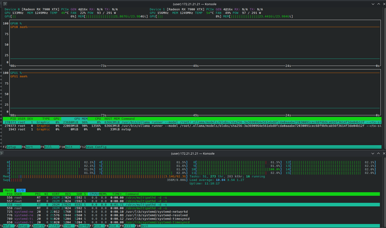

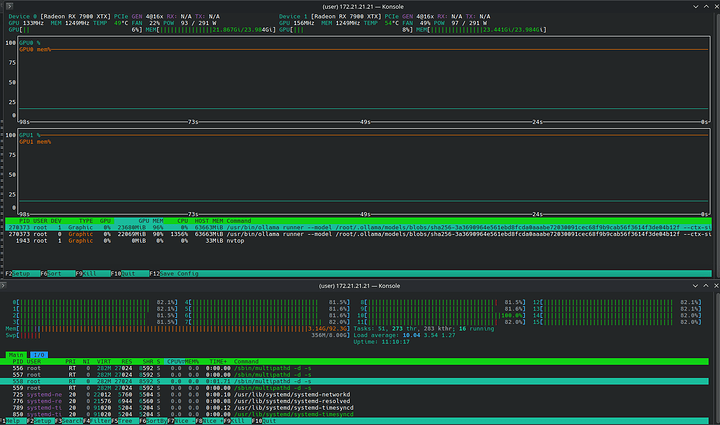

Hi,
I just got a second 7900XTX and am a little surprised that the load on both GPUs doesn’t exceed 50%.
The cards are only connected via PCIe4 X8, which I think will at least contribute to the poor scaling, but that much?

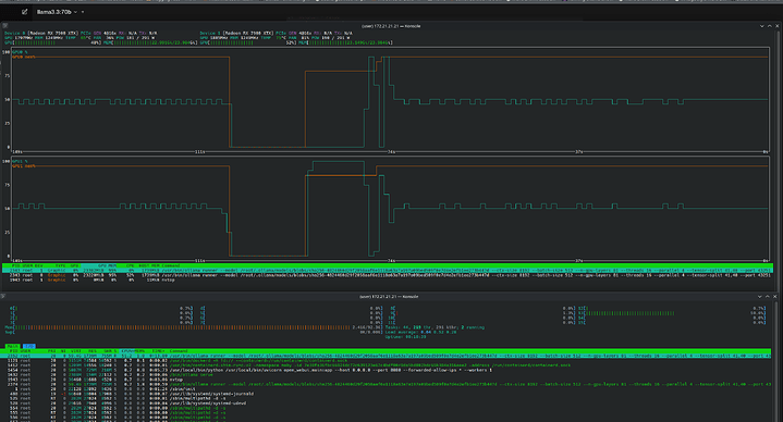

The screenshot shows Deepseek R1:70b_Q4_K_M at the beginning and then Lama3.3:70_Q4_K_M with the same input.
I’m using an Ubuntu Server 24.04.2 VM with an Ollama Docker container. Is there anything I can optimize for a dual-GPU setup?

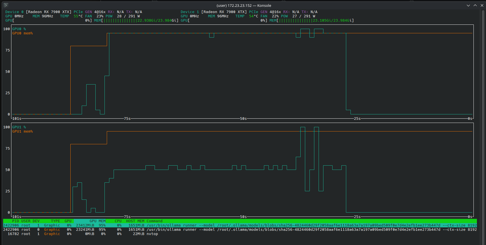

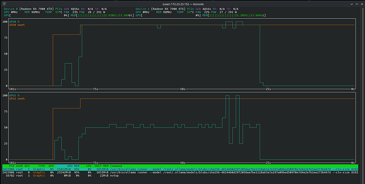

This is how the load looks like in the new system, both cards now have PCIe4 x16
llama3.3:70b Q4_K_M (39,6GB)

So here if you have all the layers offloaded to GPU you see the W7900 does ~49 Tokens while dual 7900XTX does 39 Tokens. This kind of makes sense since it has to swap between the two cards over PCI-E.
I think my models gave similar answers to some of what you posted before. I didn’t bother to interact with it though; I was just trying to measure performance with a variety of models I have loaded on my machine.
It shows that dual 7900XTX though can go quite far, even if it is ultimately around 25% slower than a single W7900 in some things.
I can come up with another couple prompts to test on smaller models. I like QWEN3 14B, the Q8 Model works nicely even if I have used Q4 quite a bit (with my own 7900XTX) before getting the W7900 for the workstation. Qwen3 14B Q4 also works with the RX9070 which is around 10-20% slower than the 7900xtx depending on the question asked and the model.
ollama and llama.cpp have simular behavior on nvidia cards as well. I ran a series of benchmarks testing with various metaparams to see what performance I could get out of it in another thread here: DeepSeek Deep Dive R1 at Home! - #153 by eousphoros
