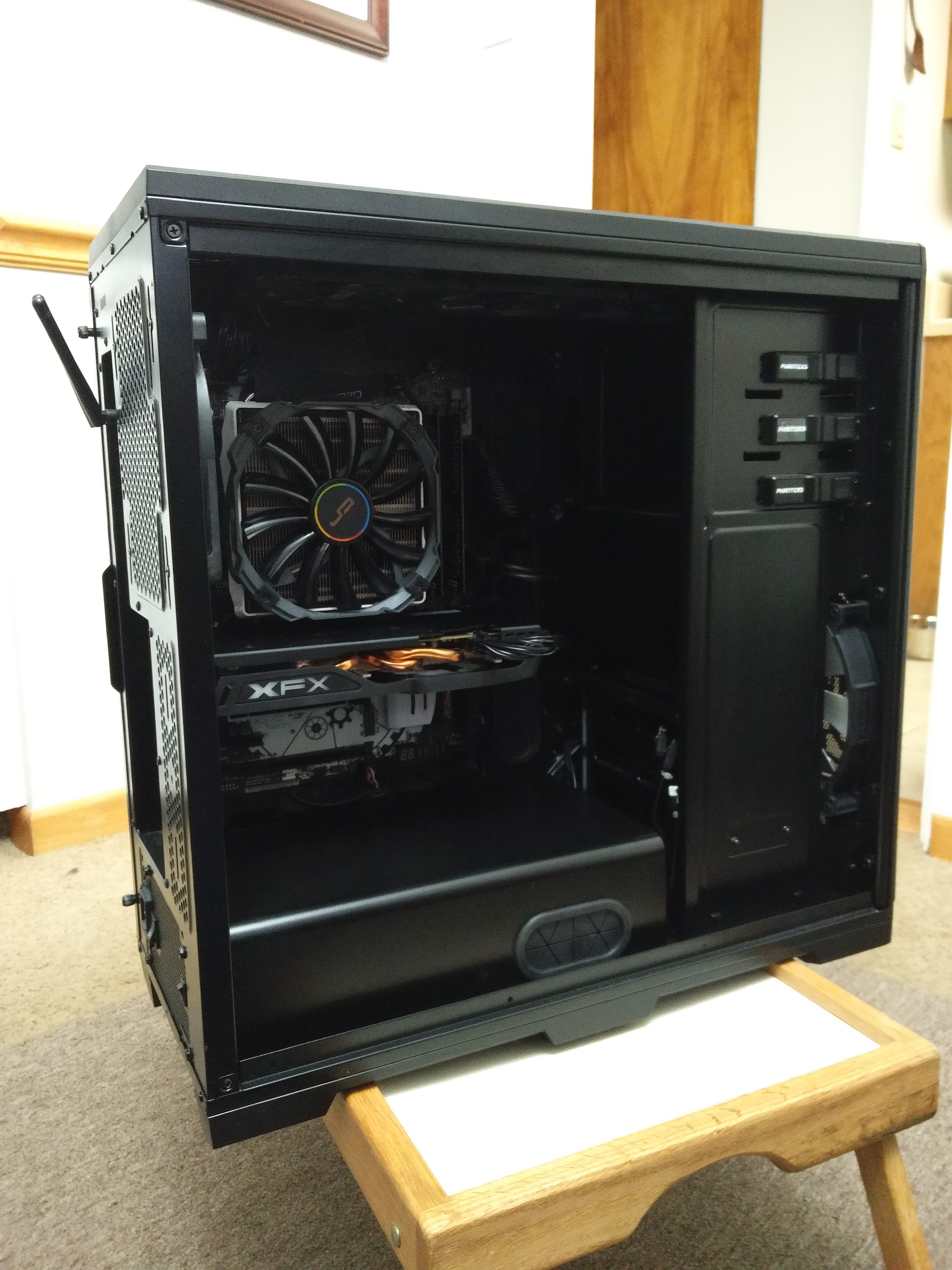

So, major events / changes:
  • RMA’d the CPU.
  • RMA’d the motherboard.
  • Switched out the 212 evo for a Cryorig C1.
  • RMA’d the motherboard again.
  • Bought a new motherboard (AsRock X370 Taichi).
  • Switched back to Ubuntu, but 17.04 this time (kernel 4.10) and Gnome.
  • Switched GTX 1050 ti for an R7870 (nvidia drivers just aren’t working out).
  • Switched R7870 for an XFX RX 480 8GB.
! ! YAY ! !

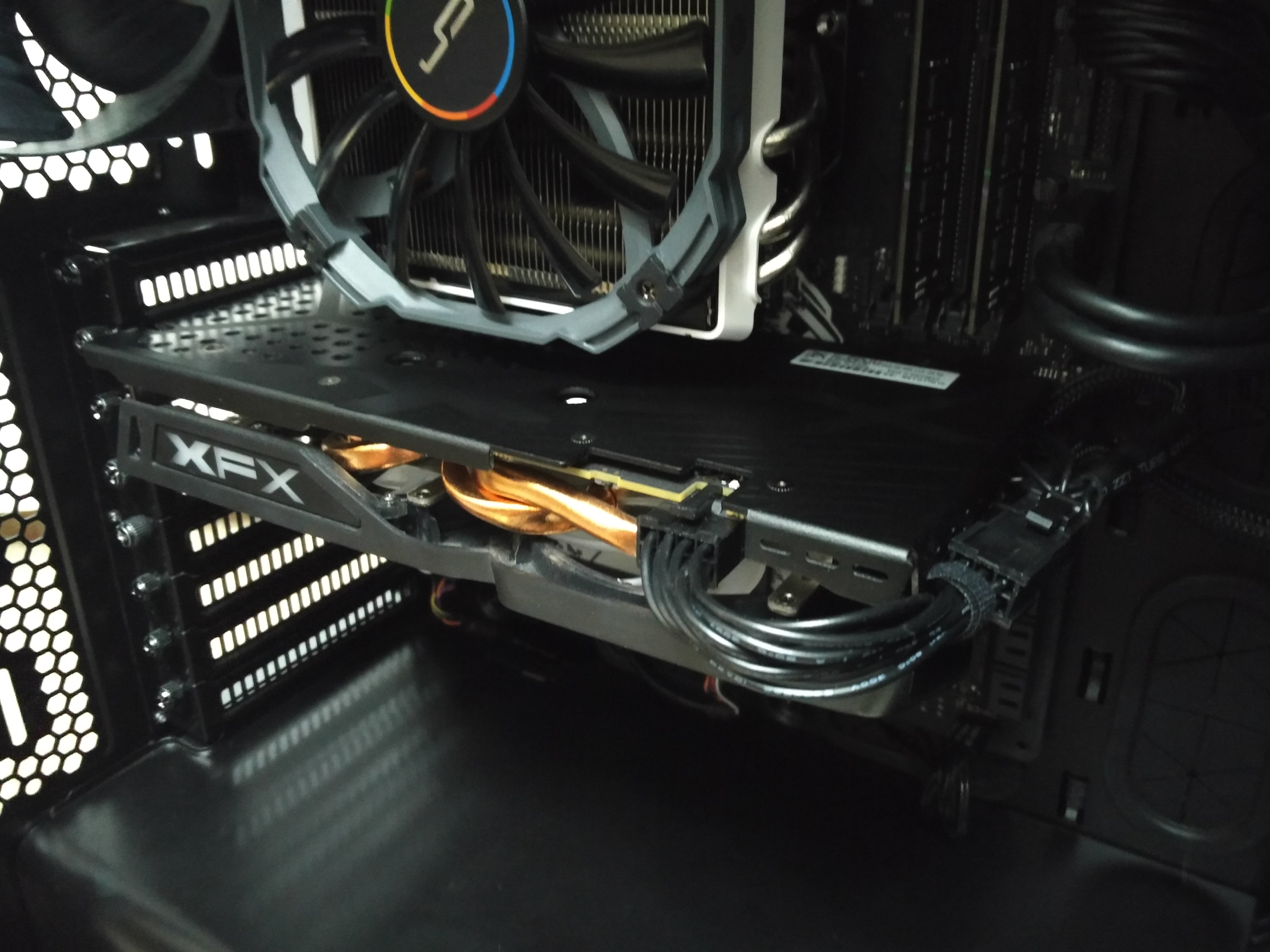

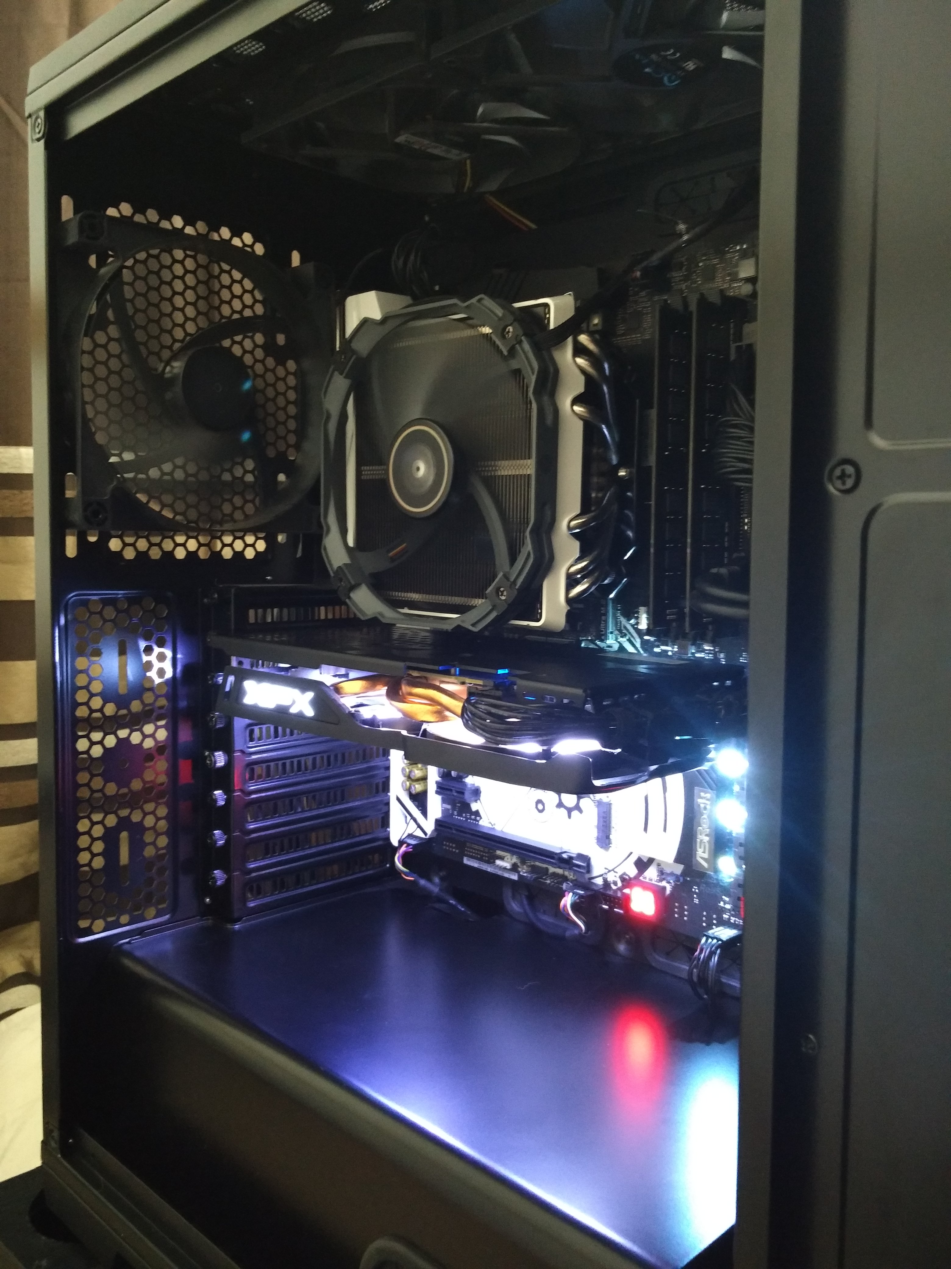

Thanks to the amazing backplate, was able to neatly tie down the power cables.
Only downside of this GPU is that the backplate and cooler almost completely cover the PCIe slot latch, so removing the card is very difficult. I have to push the latch down with a spludger, and it’s tense because it’s right above the nvme drive. Don’t slip!
~ ~ AMAYZING ~ ~
Installation, with full-disk encryption, worked first time. Sleep and Hibernation work flawlessly! Still installing stuff, but it’s looking pretty damn good so far.
