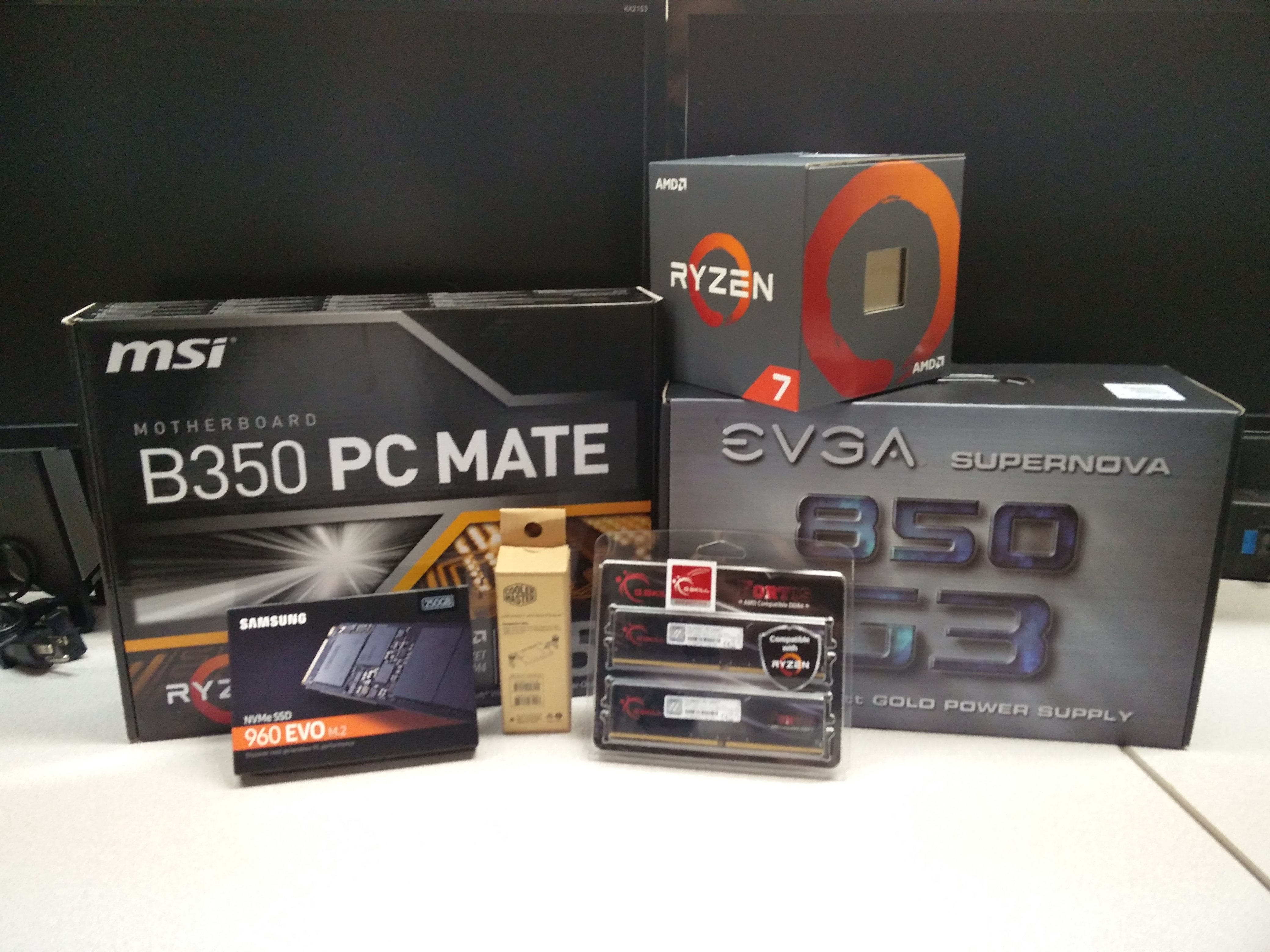

I was all ready to declare this build a success…
Then i tried to replace the side panel. :unamused:
I'm re-using the case and cpu cooler (hyper 212 evo) from my previous machine. However, it seems that a Ryzen motherboard + AM4 socket + CPU is roughly 8-12mm taller than my previous, Haswell-based "stack" (pun intended).
The case side panel hits the tops of the 212's heatpipes.
