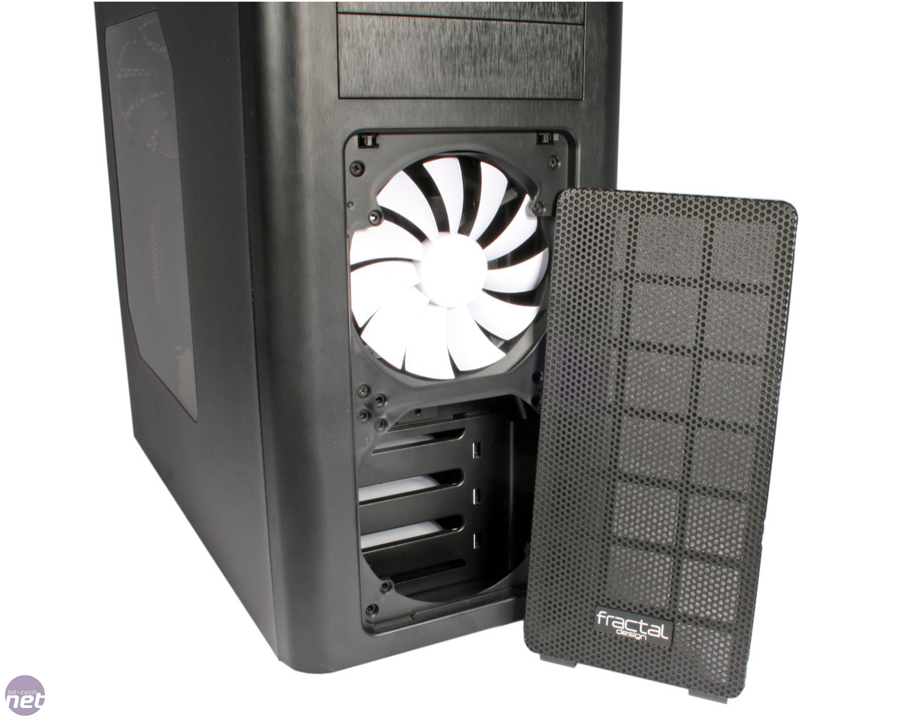

My case for example... Arc Midi R2...
If i remove the front filter, the temperature of my CPU drops 4 degrees Celsius in a few minutes. I could have benefited greatly from higher pressure fans. My current fans are 140mm Silent Series R2. They are silent. But they are not great for static pressure, and the fan filter is blocking them massively.

R4 have the closed intake... They are needed... The fans at full 12V have something like 0,8mm/h2o, which is AWFUL pressure. Belive me, higher pressure intakes with that restricted front will drop may be 3-4 degrees immediately from your CPU and 2-3 from the GPU...

The thing is, with ambient temperature of 28-30 celsius, the CPU is 58-59 with filter, 54-55 without filter... So i am kind of great thermal wise either way...
My biggest issue is the lack of import of any aftermarket fanfilters... My country only have those evercool things:![]()
I can just use black pantyhose. Both clean and unrestrictive... I'll remove the thick foam and use the plastic bracket and the front mesh to attach the pantyhose...
