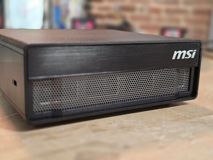

This is the MSI EdgeXpert – an nvidia DGX Spark
It has 128gb ram and can run many AI models. We reviewed it separately here, and even got Steam running on it natively (preview of RTX spark anyone?) .

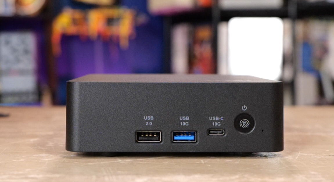

And here’s our Windows 11 MSI Cubi NUC AI+
We also reviewed it separately, here.

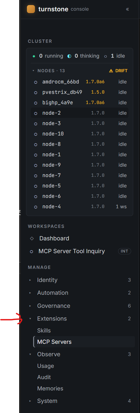

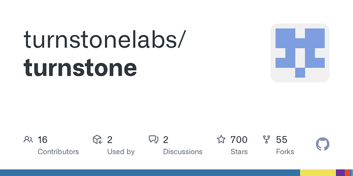

The other part of this is Turnstone:
Turnstone is a harness which means you can hook up an AI model and give it an ability to do things – tool calling.
Typically getting AI to do things effectively (quickly, lowest number of tokens, consistently) typically depends on tool calling and skills. Skills are often markdown files and, optionally, utility or helper scripts). The skill explains to the AI how to call a tool or tools (or helper scripts), how to interpret the output and most importantly what success criteria looks like. This gives the model context for what you have asked it to accomplish, and what success looks like.
You may have heard the term Agentic before.. what it means in this context is that your harness software (Turnstone in our case) could spawn several “chat” sessions that have different instructions but are all working toward the same goal.
TODO: PIC
That’s why this is called an orchestrator – it’s orchestrating several sessions with the AI model. Think of each of these as an AI chat session except that you have tool calling (for generic tools), Skills (which can provide their own tools/scripts), and, the big thing in our video here, access to MCP interfaces.

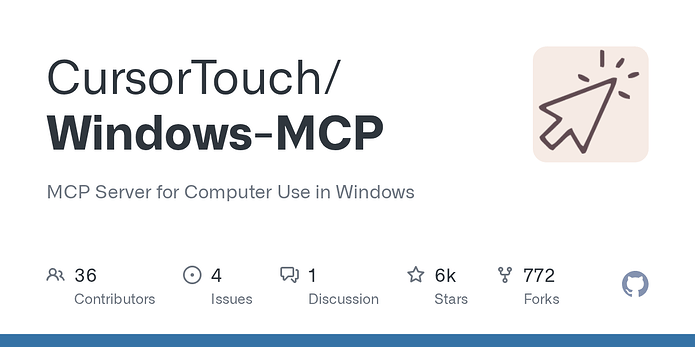

For this demo we’ll be using this Windows MCP server:

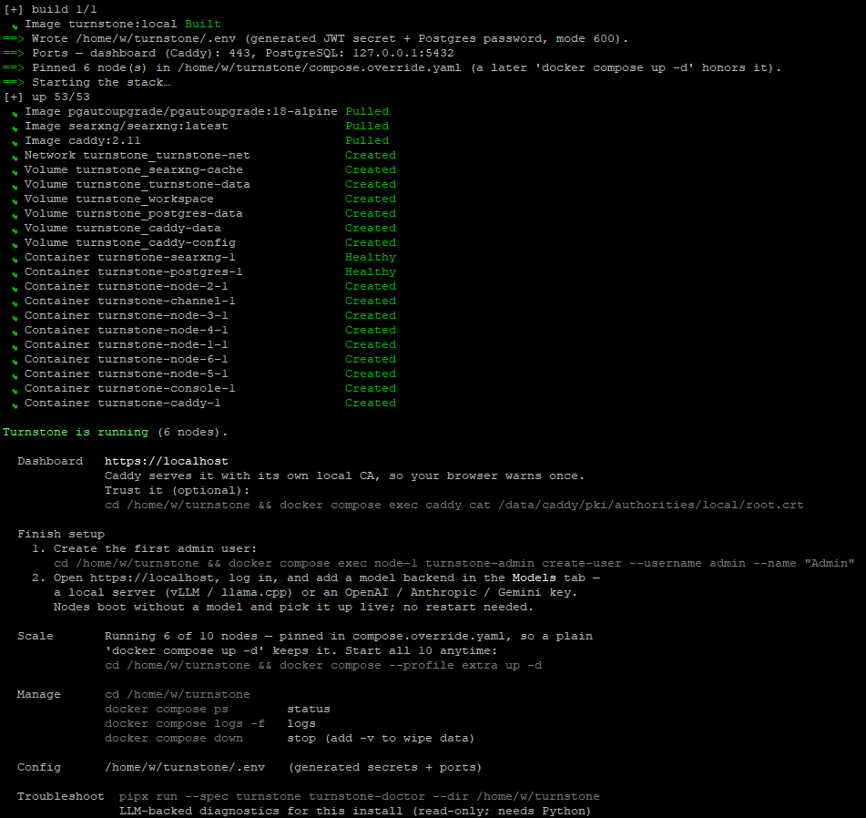

Turnstone Setup on the DGX Spark
curl -fsSL https://raw.githubusercontent.com/turnstonelabs/turnstone/main/run.sh | bash
…Check out the video for setting up Turnstone; it’s pretty slick.
Make sure that at least one AI container is running because the installer can connect to the AI container to get it to help you set everything up.

MSI Cubi Nuc AI+ Mini PC Windows Setup
Install python 3, and ux, etc
Start the MCP server on windows
python -m uv tool run windows-mcp serve --transport streamable-http --host 192.168.0.115 --port 8000 --auth-key ItsForTheLulzOrWhateverYouChose

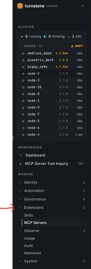

Configure Turnstone

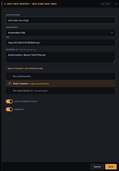

and configure the mcp sever:
Note that you need Authorization: Bearer and then the token you specified on the CLI.
*I also recommend you setup TLS as in the TLS example for this windows MCP server so that the communications layer is encrypted on your lan, but one problem at a time. *
You should see:
you may also want to click Sync to nodes

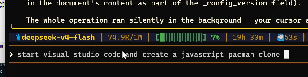

Bonus Round: Configure Hermes Agent
I was surprised by how unnecessarily cumbersome this was.
The whole secret, and the place where the Hermes installer breaks down for the uninitiated, is that they make it too easy to break if you don’t want to cloud-host your AI, or go through their router.
The desktop gui did not work for setting up a http://192.168.x.y. type local address.
  1. Install Hermes (their website/walkthrough is sufficient for this).
  2. You can create an account, but when it asks for an ai provider you can go with defaults or skip over it.
  3. run a terminal and do hermes setup. Pick FULL setup.
  4. For the model provider, pick custom, around option 32.
  5. Enter the url and port of the DGX Spark/EdgeXpert: http://192.168.0.166:8000/v1
  6. it should auto detect the model and context. You want to use the smartest model with hermes, ideally.
If you have two sparks you can try the new deepseek v4 flash nvfp4, or even run “only” the nemotron 120b parameter model as well.

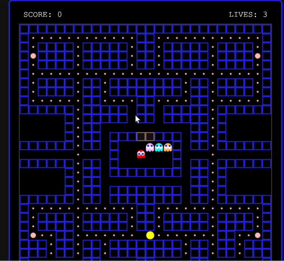

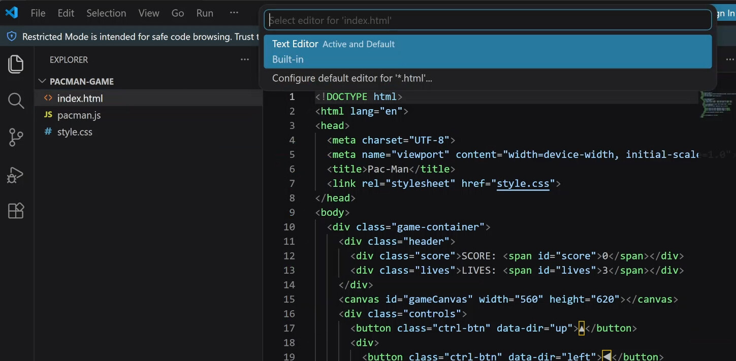

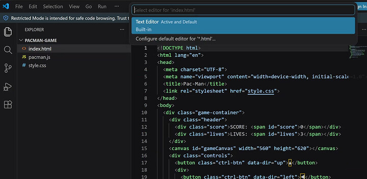

As shown in the video, it’s pretty impressive to go from this:
to this
to this
in just a few minutes.

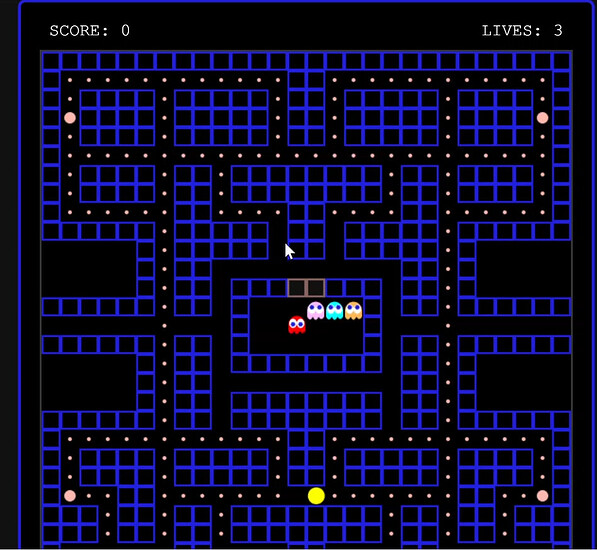

did you notice the pacman bugs? yes yes it’ll take a few passes to work the bugs out. hah.
