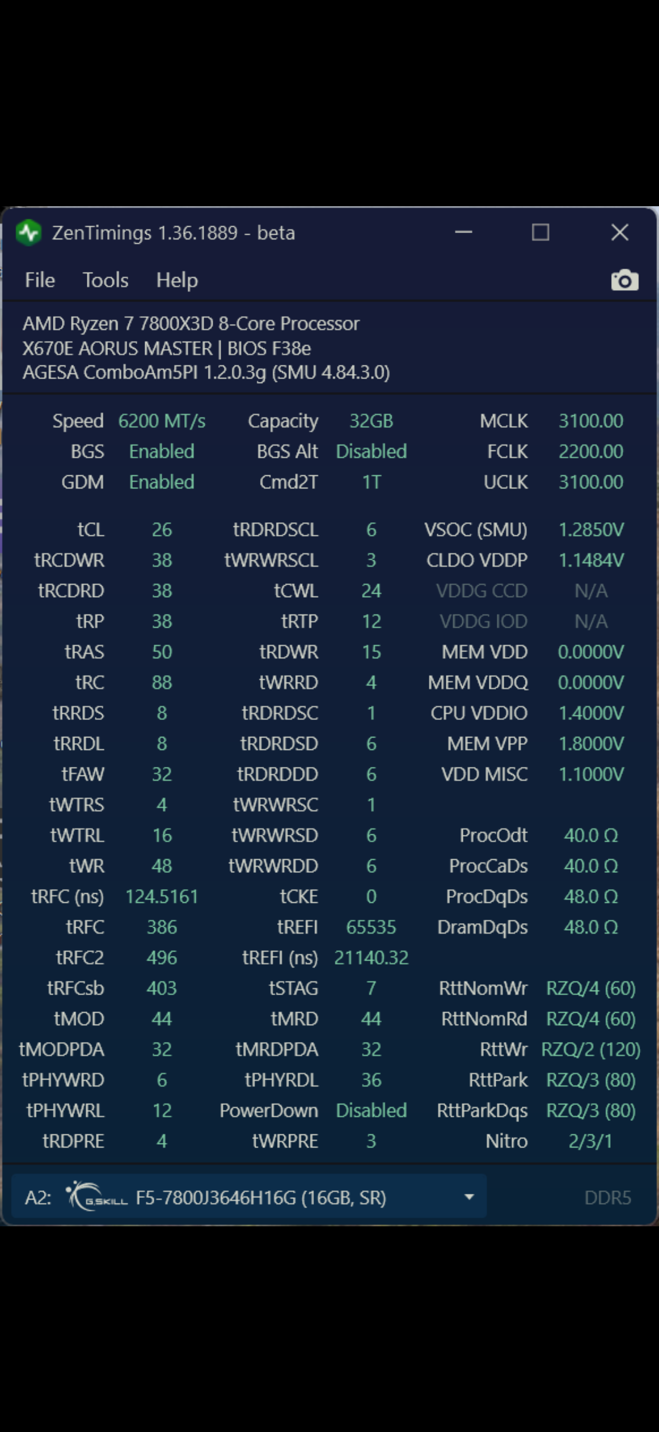

I’m having an issue getting my 16gx4 (two kits) to work I currently have one set in A one in B. I’m aiming for 5800-6000, and I have a 7800x3d with aours x670e master.
I think it’s something to do with the termination values not the voltages. Here is a pic of my stable 2 dimm to get an idea about the Quality of the Ram. It’s A-die with a xmp for 7800.
Not usually achievable. You could try a coordinate descent search on the terminations and such and see if it goes anywhere. But FWIW my experience is it’s rare to find an improvement, much less one making the transition from unstable to stable, and most steps make things worse. Spending hours periodically bricking your board and flashing back is pretty normal.
Optimal terminations depend on package, socket, mobo, and DIMM PCB impedances as well as socket type and DRAM. So they’re more variable than timings and what works well is less likely to transfer between builds. That said, I’d probably start by seeing if lowering the processor drive impedances helps any.
Hard to tell with VDD and VDDQ both being reported as 0 V.

FWIW best luck I’ve had with an AM5 2DPC 2R overclock so far’s been on Raphael, though I suspect I’m more kit than IMC limited.
Managed to do 6000Mhz CL32 on the Aorus Master X670E somehow.
Basically used the same settings I used before on the MSI, like this
But CL32 instead of CL30, and RttWr RZQ (240).
Using latest BIOS from Sept. Using one from August doesn’t work. So I guess Gigabyte did something.
