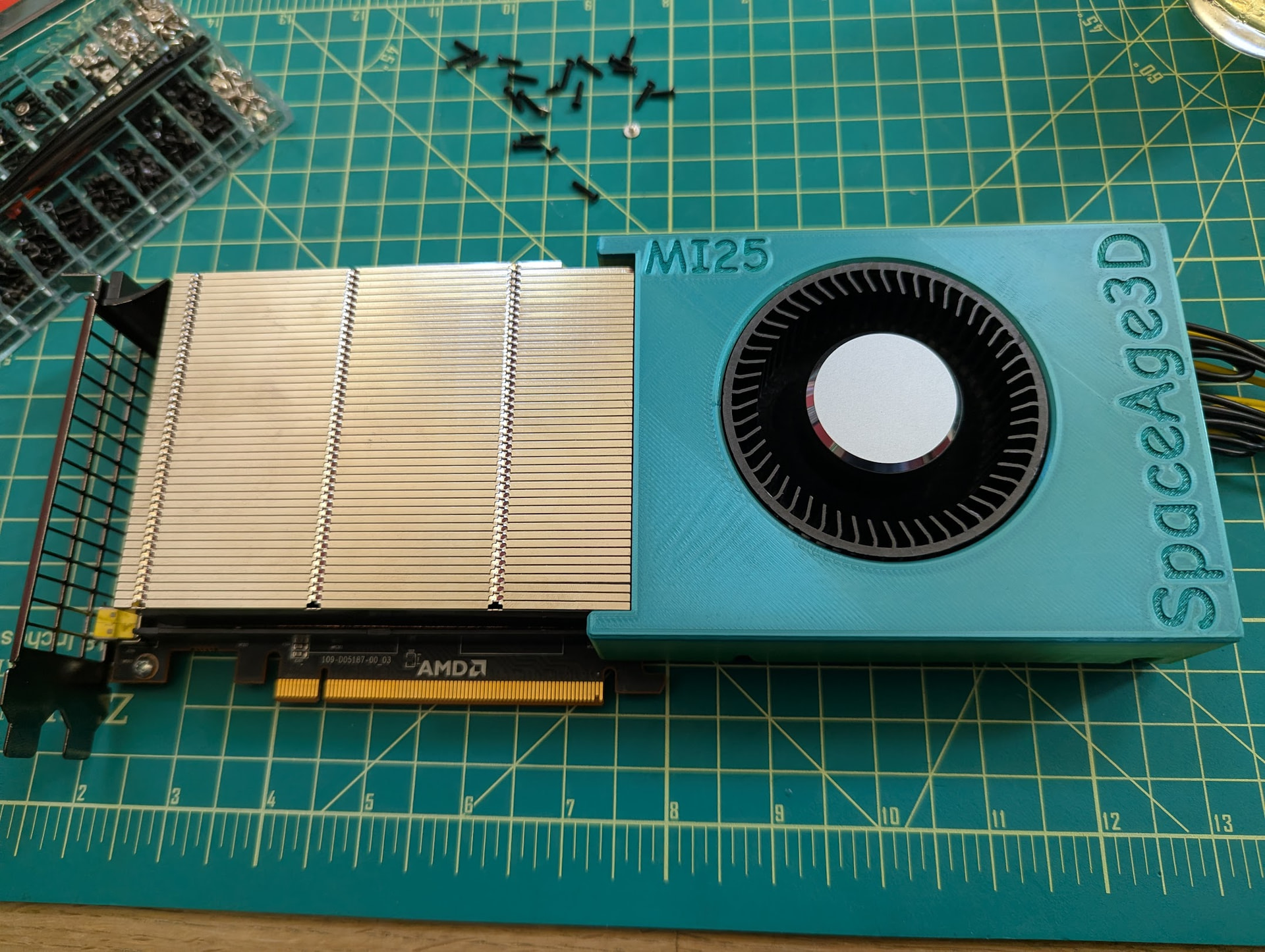

Have an AMD Instinct MI25 GPU, which as a datacenter GPU relies on airflow in the server, and thus lacks a fan. There are fan/duct designs out there, none of which I particularly liked, so iterated on an elaborate 3D-printed fan/duct design. Was very nearly done…
Then had one of those moments when you feel like the village idiot.

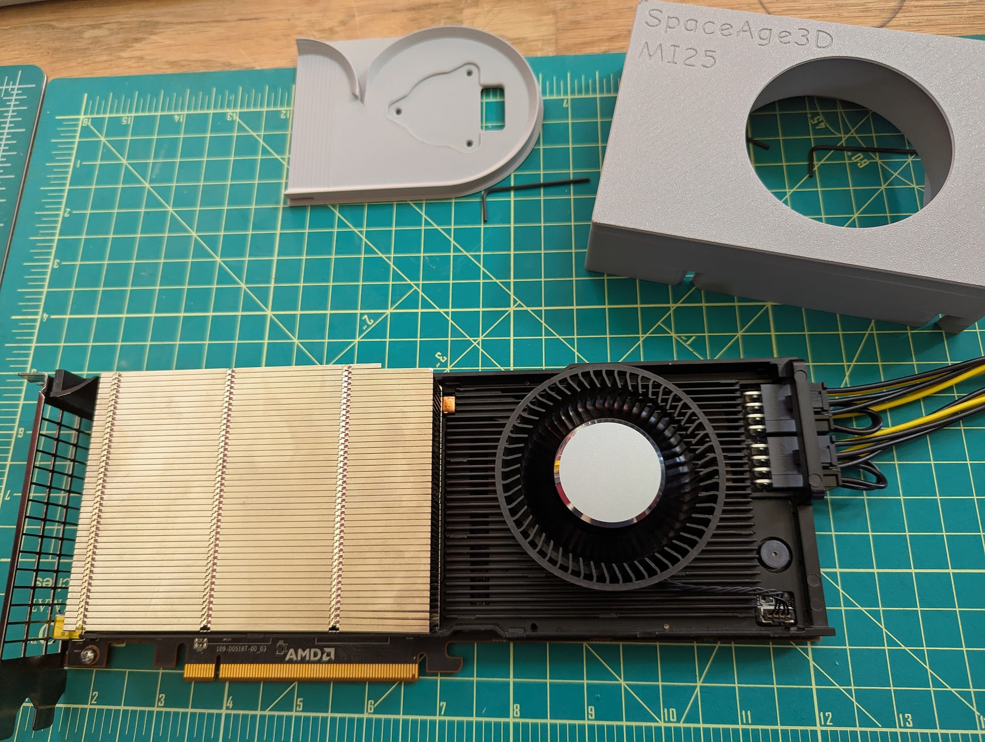

Guess what? When I thought to look, found the card comes pre-drilled(!!) with mounting holes for the fan. This on a datacenter GPU that never shipped with a fan.
Well, that simplifies things considerably. Now to re-design the duct to fit…

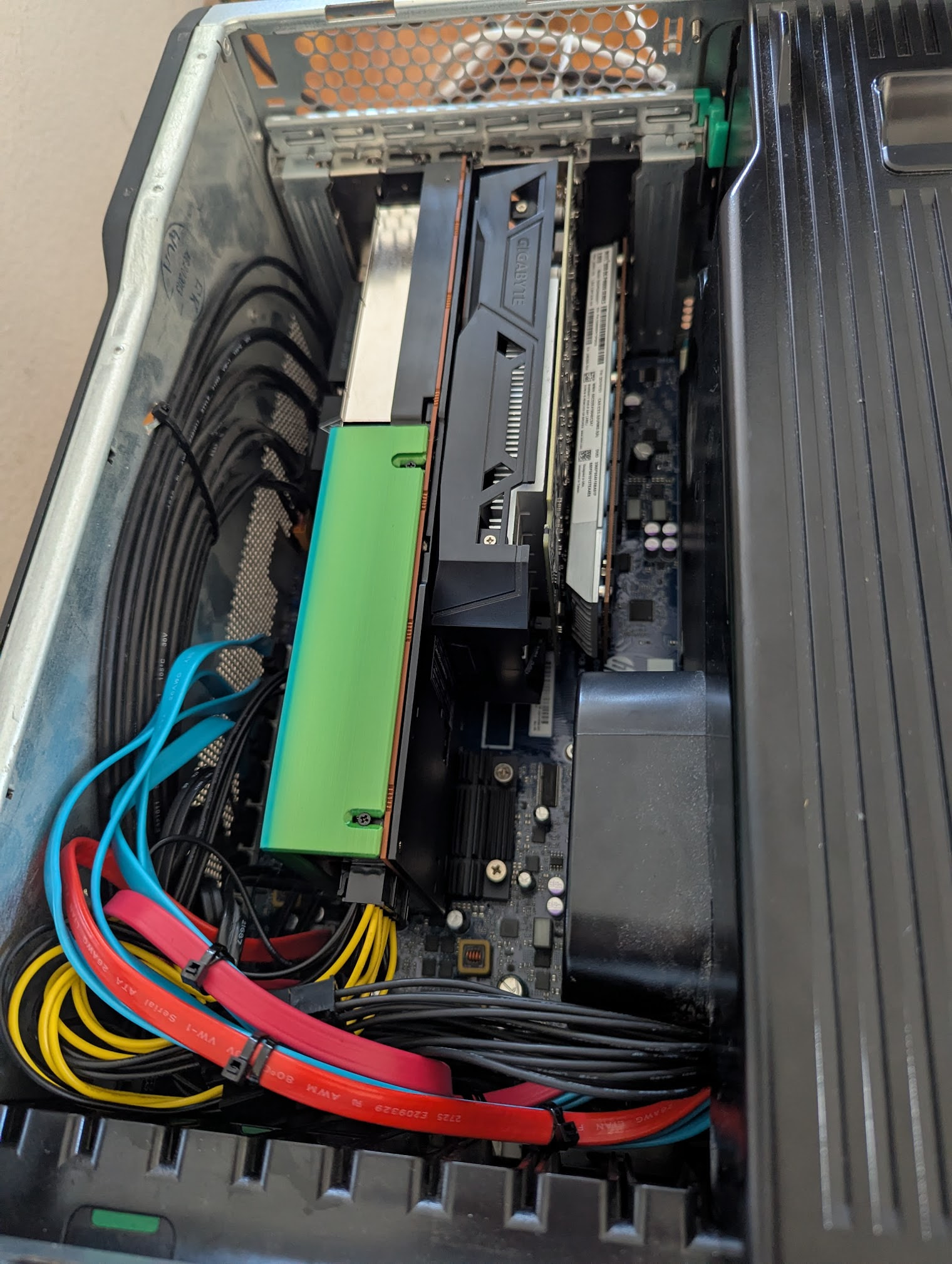

  • Designed and 3D printed a duct that fits with the fan in the stock location.
  • Loaded the latest WX 9100 BIOS: AMD.WX9100.16384.171219.rom
    • No joy with the BIOS/flash tool amdvbflash4-104E.
    • Works with later amdvbflash_linux_4.71 as allows override.
  • Linux and nvtop see the (now) WX9100, and warm air comes out the card back.
Have not yet put under load.

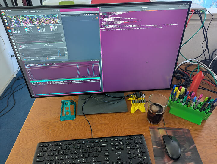

Still testing…
Working!!!

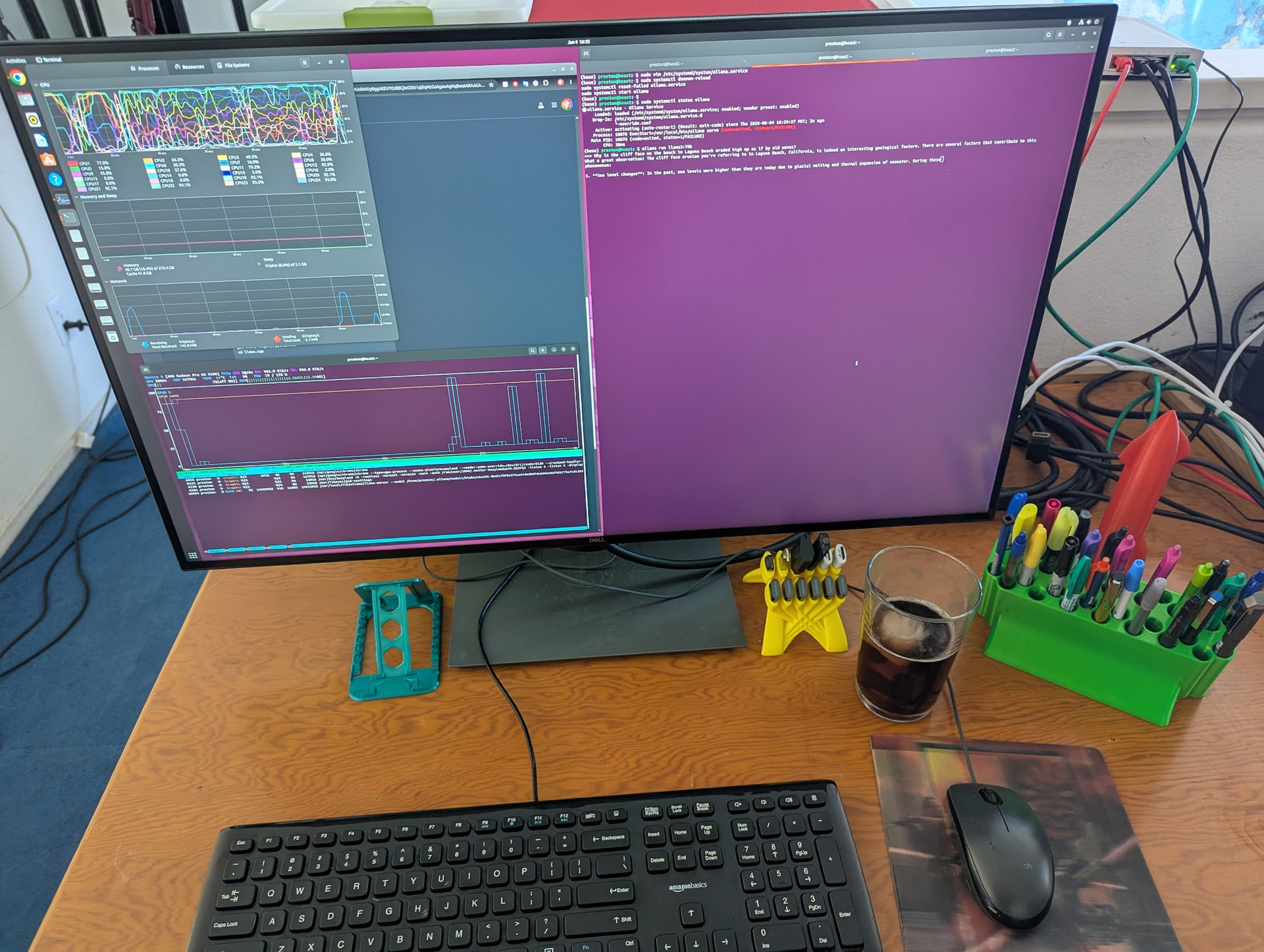

Ran a variety of LLMs, and the GPU stays (relatively) cool - in the 70-80C range, so the fan/duct design works. Fan is near-silent, so the GPU-specific fan works well with the 3D-printed duct.
Was somewhat skeptical of my duct design … but it works! :slight_smile:
The low-profile duct fits cleanly into the case.
And temperatures when active are well-controlled.
One more project checked off my list! :slight_smile:

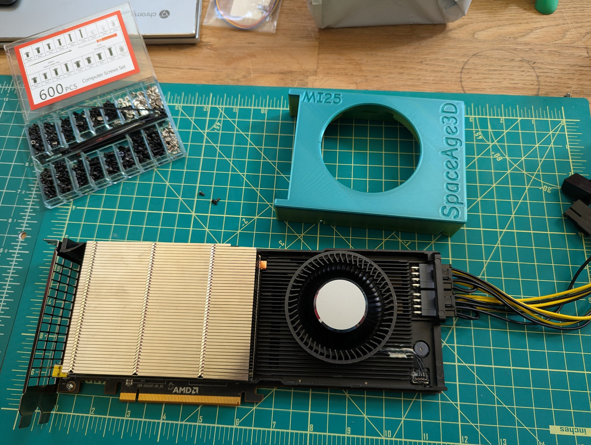

What you need:
To adapt the card you need to:
  1. Remove the stock cover (save the screws).
  2. Attach the GPU fan (needs 2mm screws) though the existing holes in the card.
  3. Plug in the fan’s 4-pin connector to the card.
  4. Glue down the fan-cable to keep away from the fan.
  5. Attach the custom duct using same holes/screws as for original cover.
That gets you working GPU hardware.
Also, IMHO this is a much cleaner solution than the existing offerings. :slight_smile:

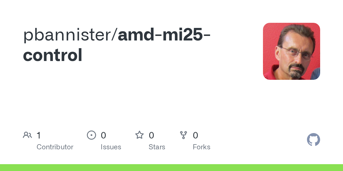

Where this ends is created a service that runs a script to actively monitor and control the MI25 fan. So far, this seems to work. The needed scripts are in:
