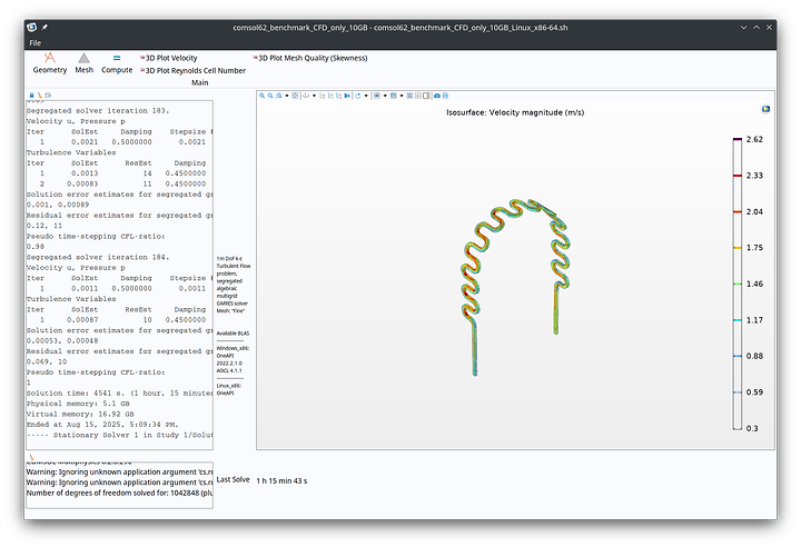

I’m trying to run the 10GB and maybe 60GB sims on linux and have some problems. The runtime installed correctly, but when I open the simulations, they load and open, but after about half a second they close again. Have I installed something wrong here, or is it an error when trying to run the simulations?
I’m running openSUSE Leap 15.6, KDE on a framework 16 for reference. I installed both simulations using the konsole command and there were no issues.
It’s typically only the relatively simple or small problems that benefit from the 3d v-cache EPYCs, problems that have less interconnected-ness among the different mesh elements. Since openfoam is limited to only the finite volume method it’s problems aren’t densely connected. I’d imagine there are quite a few problems in ansys they would not run well on
It would depend on the problem being solved, the smaller problems would likely benefit more from the generally lower latency the 2-4 channel DDR5 system would have over the DDR4 system… not sure where exactly the line between “small” and “not small” is though.
I’d argue that the DDR4 EPYCs would not have any advantage in price to performance compared to newer systems due to the cost of electricity they’d use over a new system. I’m of course assuming that the system would get a lot of run time at full tilt solving problems.
EDIT: whoops, this reply had been sitting in my web browser and never actually posted.
Do the simulations close when you click the “Compute” button or are they closing all by themselves right after launching?
To rule out graphics problems you could run the simulation with the -3drend sw argument right after .sh of the file to force the software graphics renderer to run which typically has better compatibility with all the different Linux desktop environments than the default OpenGL renderer.
They are closing by themselves right after launching. I’ll have a go at adding that argument and I’ll see if there’s an improvement. Thanks
It’s taken me a while to get round to testing again, but I tried what you said and it’s working perfectly now. Thanks very much

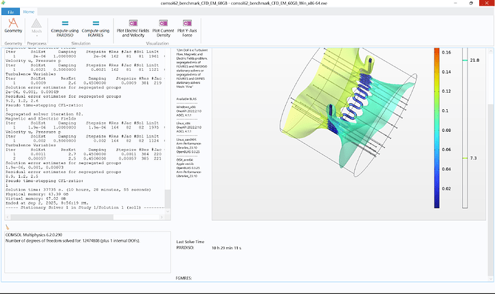

Took ages, but it’s done. Framework 16 7840HS, 64GB ddr5 5600mhz, Windows 11, CFD-EM in 10h 29m 11s with the PARDISO solver.
