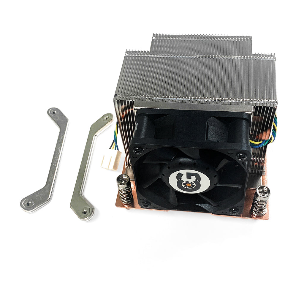

This isn’t 1-to-1 applicable because there’s no XE02 for the little Intel sockets yet, but the fan recommendations are solid:
It is not a server socket orientation board. Is that going to be an issue? Am I going to need to find one of those?

For a performance option, there is only Dynatron. My servers are built for low power and low noise.

It’s possible that could be an issue, but generally LGA1700/1851/1954 have more versatile mounting than AM5 so the chances of you being able to rotate the cooler 90 degrees without having to modify it are high.
You best bet under what is currently available is probably something like a white label 2u vapor chamber cooler with the 9RA fan swap:
