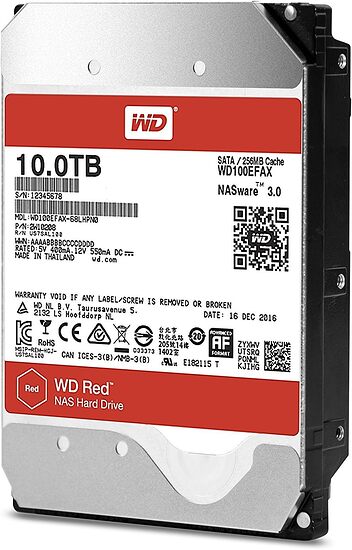

It’s not even that much cheaper if you want to get 10TB of storage and a single drive of redundancy. You’d want slower spinning hard drives since the faster ones will run hotter, so you would rationally go for 10TB WD Red’s, which are $380 a pop and you’d want two.
